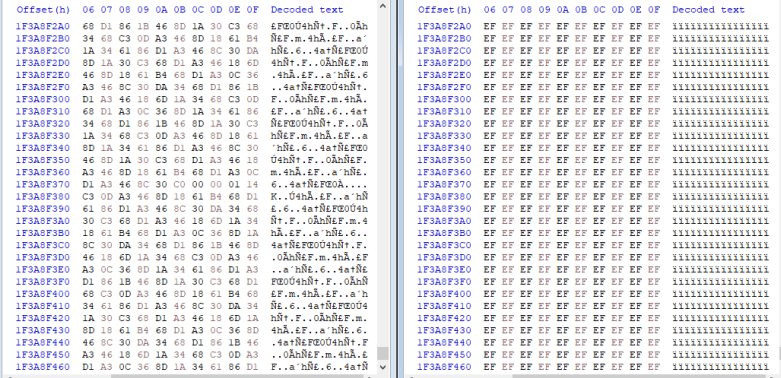

While backing up my collection I came across a disc (Finnish edition of SpongeBob RoundPants) that displayed no errors if converted to MKV straight from the disc, but threw several errors if the same thing was done from an .iso backup made in MakeMKV. I then made an ISO through ddrescue and that one did not display any errors either. Comparing the two dumps in a hex editor, I found entire chunks of data in the ddrescue dump that were simply missing in the MakeMKV one:
This makes me believe MakeMKV's RipGuard implementation may be slightly flawed. In addition to this, all ripguard spots are filled in with "EF" and occassionally a string saying "READ ERROR" which is honestly quite strange.
There are also a few other DVDs (such as the UK release of SpongeBob The Great Sleigh Race) where the ISO backup completely fails on MakeMKV around RipGuard spots, but works without troubles through ddrescue.
Logs from the MakeMKV RoundPants ISO:

Logs from the ddrescue RoundPants ISO:

The interesting part is that I can rip all the titles from the DVD but I get a LOT of messages during Opening. Here is the last of them (they are almost all the same as these, just SO MANY more of the first line below):
The source file '/VIDEO_TS/VTS_04_1.VOB' is corrupt or invalid at offset 194560-208896, attempting to work around
Too many AV synchronization issues in file '/VIDEO_TS/VTS_04_1.VOB' (title #-) , future messages will be printed only to log file
The source file '/VIDEO_TS/VTS_04_1.VOB' is corrupt or invalid at offset 12288, attempting to work around
DEBUG: Code 0 at `@EwUL>S'%f.9\7(hz::213132376
When trying to Backup this DVD, it FAILS, with these messages:
Backing up disc into folder "F:/Mr Woodcock (2007)/Mr Woodcock (2007).iso"
Calculated BUP offset for VTS #1 does not match one in IFO header.
DEBUG: Code 1 at u*9'>(mDm1Nfak:29400071
IFO file for VTS #1 is corrupt, VOB file must be scanned. This may take very long time, please be patient.
Calculated BUP offset for VTS #2 does not match one in IFO header.
Calculated BUP offset for VTS #3 does not match one in IFO header.
Calculated BUP offset for VTS #4 does not match one in IFO header.
DEBUG: Code 4 at u*9'>(mDm1Nfak:29400071
IFO file for VTS #4 is corrupt, VOB file must be scanned. This may take very long time, please be patient.
Calculated BUP offset for VTS #5 does not match one in IFO header.
DEBUG: Code 5 at u*9'>(mDm1Nfak:29400071
IFO file for VTS #5 is corrupt, VOB file must be scanned. This may take very long time, please be patient.
Calculated BUP offset for VTS #6 does not match one in IFO header.
DEBUG: Code 6 at u*9'>(mDm1Nfak:29400071
IFO file for VTS #6 is corrupt, VOB file must be scanned. This may take very long time, please be patient.
Calculated BUP offset for VTS #7 does not match one in IFO header.
DEBUG: Code 7 at u*9'>(mDm1Nfak:29400071
IFO file for VTS #7 is corrupt, VOB file must be scanned. This may take very long time, please be patient.
Calculated BUP offset for VTS #9 does not match one in IFO header.
DEBUG: Code 9 at u*9'>(mDm1Nfak:29400071
IFO file for VTS #9 is corrupt, VOB file must be scanned. This may take very long time, please be patient.
DEBUG: Code 17 at "_8Y~gp]N83/.*7Rw:213131318
DBG ASSERT: ,D$X},3rf3%lW*cX*oYLZ[R zpTbU*N{8u+ at u*9'>(mDm1Nfak:29402003
Calculated BUP offset for VTS #17 does not match one in IFO header.
DEBUG: Code 0 at B`ut4y]!X\p5gw'4V:jX:121266097
Backup failed
What would cause this behavior? Is there any workaround to get a Backup (ISO) in this case?
