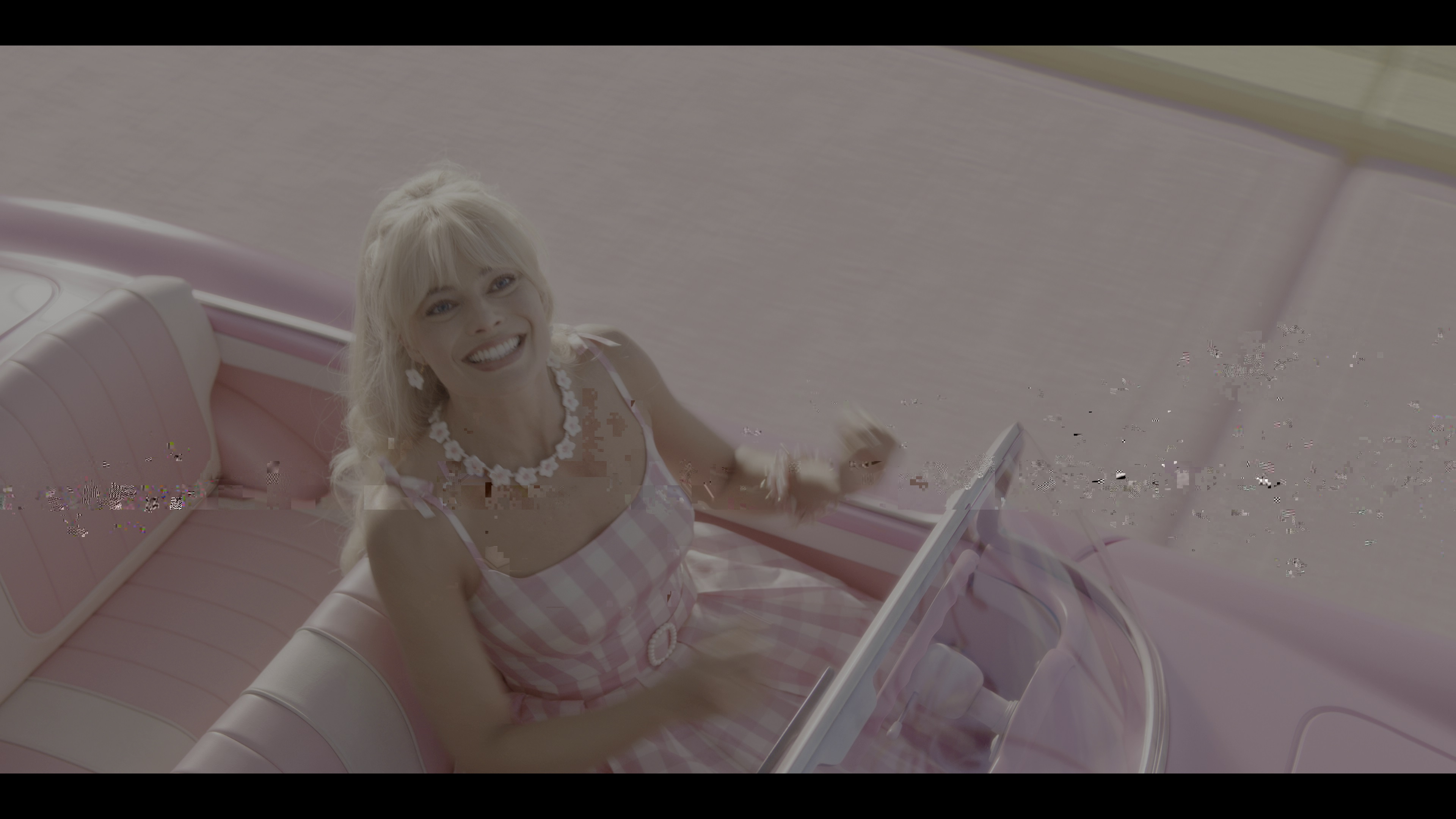

I've have recently been trying to rip UHD 4 films, and finding on playback some random pixelation issues.
I've checked the actual files and its definitely on the ripped image, so not a 'playback' issue. The image 'defect' is always in the same place on a particular file, and seems to be more prevalent when hi-bitrate scenes (action etc) are being played.
Virtually all the 4K discs I've ripped have some defect on the image at some point in the film.
Using MakeMKV and Leawo on the same film tends to produce overall good results, but with some pixelation at some random point in the film (never the same place for each rip, so not a disc issue).
I'm using an Archgon 8102 external drive, and wondering if the issue is there, or have people found its a RAM issue?
Can't say I've ever noticed an issue with DVD or 1080 bluray rips, albeit tend to use the fairly new pioneer drive for those (which has too new firmware for UHD ripping).
Are people getting genuine lossless results without defects (in MKV) and all their 'successful' rips?
All mine are playable and look excellent just with the random pixelation happening a few time per film.
Screenshot of a frame from 'Barbie' with the pixelation present.

That sort of pixelation looks exactly like when my computer is struggling to play a 4K rip. On my home theater setup, I play uncompressed 4K rips and I never see artifacts like that. I use MakeMKV to rip my discs and if I get a successful rip, it always looks good and is free from defects.
I know you said you don't think it is a playback issue… but it sure looks like a playback issue.
