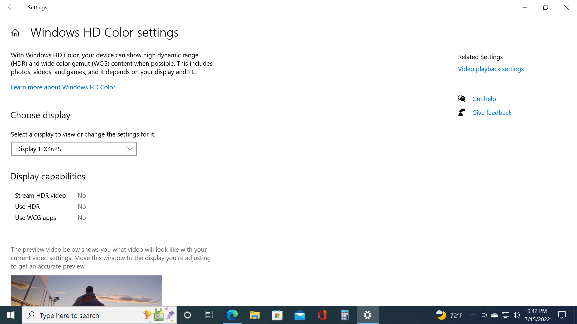

I could really use your help since I just purchased the NEC V754Q and may have made a mistake because of the HDR.
https://www.sharpnecdisplays.us/products/displays/v754q
I was told this display supports HDR by NEC multiple times. Although, it looks like it's HLG and PQ. Is this a good thing and will Windows show that the NEC V754Q is HDR compatible in the screen shot below? Right now, I'm using an older SDR, NEC display so the screenshot shows it's not compatible in the three options. The 3 options I'm referring to are stream HDR video, use HDR and use WCG apps.

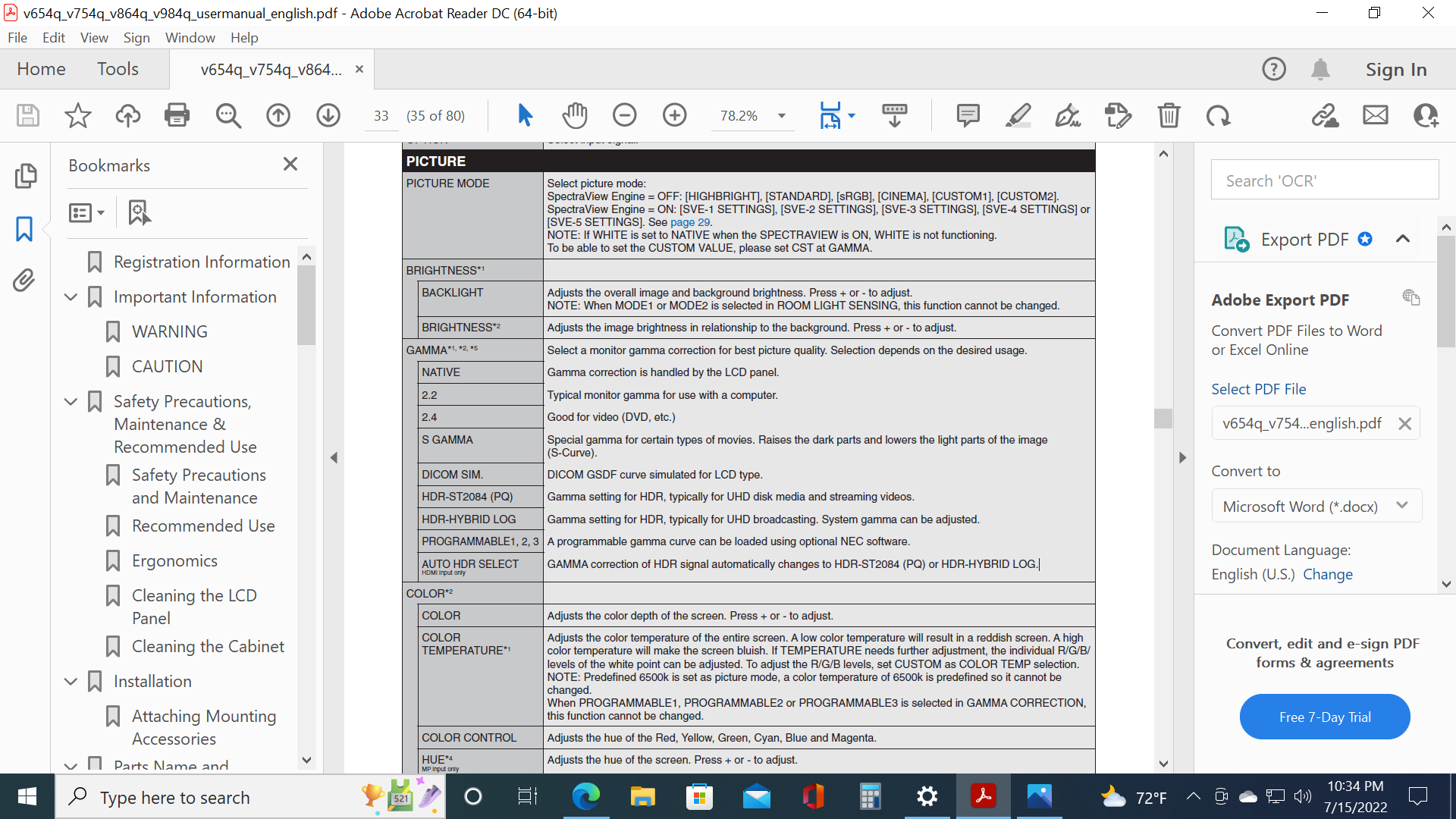

This is what the manual says for the V754Q, under the gamma options.

- Windows HDR Settings.png (214.36 KiB) Viewed 10827 times
- NEC V754Q HDR.png (334.62 KiB) Viewed 10827 times

the reason hdr might not be showing up is sometime you need to enable advanced picture mode or something like that different from manufacturer to manufacturer
for lg its ultra deep color sony its enhanced hdmi mode ect...
yes the rips can fall back to standard hdr 10 if your display does not support the other modes
also just saying if you look at pg 20 of the user manual there is no 4k 3840x2160 24HZ/23hz mode it only has 24hz for 4096x 2160
most movies are 23.97 so for most tvs thats the 23hz mode.
and again just because it has a 24hz mode does not mean its judder free and for displays like this its hard to tell if its not reviewed by a place like rtings if you look at the review i sent you will see the judder has a perfect 10 score for 24hz

I currently have a rtx2080fe, but plan to upgrade.
To make things more simple, do you know if the nec can have all 3 display capabilities in the windows HD color settings? Do you think the nec will display hdr well when playing mkvs?

2080 should do hdrleosantare wrote: ↑Sat Jul 16, 2022 5:04 amI currently have a rtx2080fe, but plan to upgrade.
