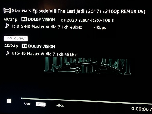

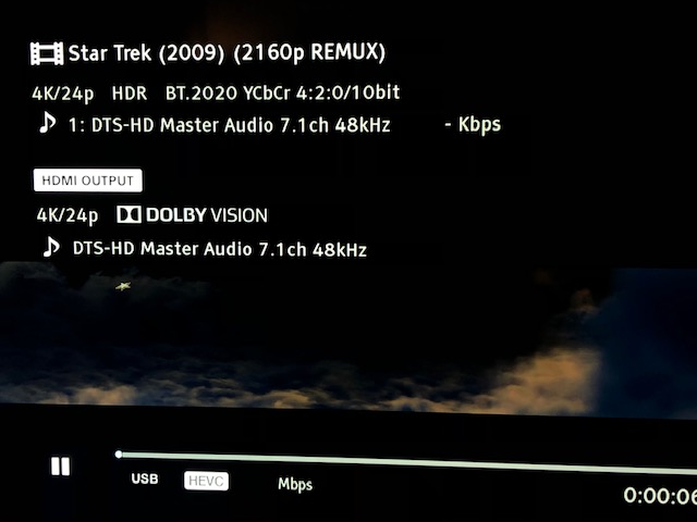

I have been thinking of redoing my MKVs now we have DV support into TS format and playing with the modified exoplayer. Before I embarked on the task I did a test with an older MKV I had and remuxed it to M2TS (apparently less processing for the player) and tried it on my setup which is:
Sony XH95 TV
Sony X800M2 Player via USB
This seems to trigger DV, but given Sony's less than perfect DV implementation I wanted confirmation that the DV meta data was being used. I also did the same with a non DV file and this appears not to have a DV track going into the player (even though everything is output in a DV format on this player once DV is turned on). I lose Atmos as it's discarded by TSMuxer when I load the file but I get DTSHD (I don't have Atmos speakers so it's no big deal).
The Media info before and after for both these files are below and I've attached a screenshot of what the player shows as the input and output files. Can anyone confirm this is real Dolby Vision from this information?
As a side note I couldn't get this to work with the nightly TsMuxer (although that was with Midsommar) - So I used the 04.06 fix version.
Last Jedi DV.jpg (58.31 KiB) Viewed 8702 times
Star Trek HDR 10.jpg (48.7 KiB) Viewed 8702 times
THE LAST JEDI BEFORE REMUX

THE LAST JEDI AFTER REMUX
General
Complete name : F:\Star Wars Episode VIII The Last Jedi (2017) (2160p REMUX DV).m2ts
Video #1
Menu ID : 1 (0x1)
Format : HEVC
Format/Info : High Efficiency Video Coding
Format profile : Main 10@L5.1@High
HDR format : SMPTE ST 2086, HDR10 compatible
Video #2
Menu ID : 1 (0x1)
Format : HEVC
HDR format : Dolby Vision, Version 1.0, dvhe.07.05, EL+RPU, Blu-ray compatible / SMPTE ST 2086, HDR10 compatible
Audio #1
Menu ID : 1 (0x1)
Format : DTS XLL
Format/Info : Digital Theater Systems
Commercial name : DTS-HD Master Audio
Compression mode : Lossless
STAR TREK 2009 BEFORE REMUX
General
Complete name : U:\Star Trek (2009) (2160p REMUX)\Star Trek (2009) (2160p REMUX).mkv
Video
Format : HEVC
Audio #1
Format : MLP FBA 16-ch
Format/Info : Meridian Lossless Packing FBA with 16-channel presentation
Commercial name : Dolby TrueHD with Dolby Atmos
Audio #2
Format : DTS XLL
Star Trek 2009 AFTER REMUX
General
Complete name : F:\Star Trek (2009) (2160p REMUX).m2ts
Video
Menu ID : 1 (0x1)
Format : HEVC
Audio #1
Menu ID : 1 (0x1)
Format : DTS XLL
