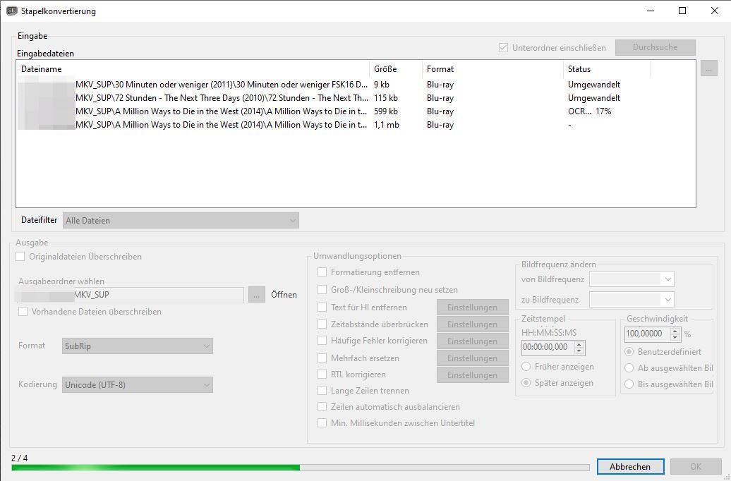

Sometimes its really funny. I'm rippping several weeks now. In this time I tried to find out if there is any app out there being able to batch convert multiple graphical VobSUB (DVD) and PGS SUP (Blu-Ray) subtitles to SRT (text). It seemed that there is no solution out there and even the most popular OCR tool Subtitle Edit states in its FAQ:
Subtitle Edit can also convert subtitles via command line (text formats only)
So I'm opening day by day every single MKV through Subtitle Edit and tried to find the forced subtitle, manually starting the OCR and setting the correct SRT filename. This cost me so much time.
And today I tried in the GUI under "Tools" the "Batch convert..." feature and wait... what...
2019-11-22 23_50_53.jpg (81.07 KiB) Viewed 40331 times
Subtitle Edit is able to automatically convert/OCR'ing a complete folder of SUP subtitles recursively with one click :shock:
Did you know that? In combination with the automatic forced SUP export this saves me so much time! I mean, I'm doing nothing now. 8)
I never thought this would work as there is no batch option displayed that is usually part of the manual OCR Tool like the language setting, the engine mode, word guessing, etc. I mean which setting uses Subtitle Edit in this mode and why the hell is nobody mentioning this feature?! Crazy.

Which language and which engine are you using? Do not forget: You need to install the recent tesseract version and select the correct language by OCR'ing one file manually. After that the batch tool re-uses this setting. You can not select the language or engine through the batch tool. This is something like a bug:
https://github.com/SubtitleEdit/subtitl ... -561696725
I OCR german texts and I need to correct maybe 1 out of 20 forced subtitles with really small typos for example it recognizes sometimes a combination of letters like "IVI" as the letter "M".
