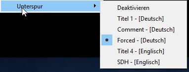

After creating the MKV through MakeMKV I ask myself how to name the different subtitles and audio tracks. This is how I do it at the moment:
Subtitles
Regular or {Empty String}
The usual subtitles.
Forced
For forced subtitles. This is the only tag that is supported by Plex
SDH
Subtitles for the deaf and hard-of-hearing.
Comment
Director's or actor's comments.
Lyrics
Song lyrics only
Info
Information and facts, mostly in graphical popups
Example:
2019-06-15 20_49_03.jpg (10.09 KiB) Viewed 38785 times

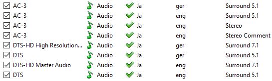

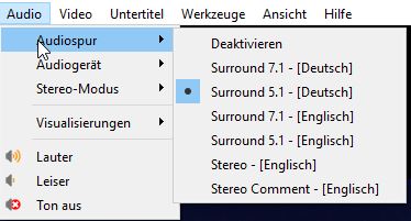

Audio tracks
Mono, Stereo, Surround 5.1, Surround 7.1...
The default values
{default value} Comment
{default value} Desc
Describing audio for blind or visually impaired people.
Example:
2019-06-15 20_49_10.jpg (18.5 KiB) Viewed 38785 times
I wonder why MakeMKV does not add the audio codec to the name like "DTS-HD MA 7.1". Isn't it allowed to choose more specific names or what is the reason for such general names?

@Grauhaar
Yes. its MA, 5.1 and Stereo:
2019-06-16 11_22_47.jpg (20.44 KiB) Viewed 38764 times
Does DTS-HD HR 7.1 or DTS-HD MA 7.1 contain a 5.1 or 7.1 Core? I tried to find that out, but I was not successful. Thats the reason why I did not remove the stereo track by now. If the separate 5.1 track is useless, why is it part of the Blu-Ray?
At the moment I do not have any DTS equipment at all, but I do not know what the future holds :wink:
EDIT:
Yes the core is 5.1 as the eac3to output shows:
6: DTS Hi-Res, German, 7.1 channels, 2046kbps, 48kHz
   (core: DTS, 5.1 channels, 1509kbps, 48kHz)
   "Surround 7.1"
7: DTS, German, 5.1 channels, 1509kbps, 48kHz
   "Surround 5.1"
8: DTS Master Audio, English, 7.1 channels, 24 bits, 48kHz
   "Surround 7.1"
9: DTS, English, 5.1 channels, 1509kbps, 48kHz
   "Surround 5.1"
As this core is fix and an important part of the 7.1 playback I think it misses the 2 additional surround back channel information. Some people think DTS mixes down from 7.1 to 5.1 as DD does, but as far as I know the DTS core is a fix fallback for backward compatibility. I mean, why having a fixed core if the final result is mixed down anyway? Does not seem logic to me. What do you think?
