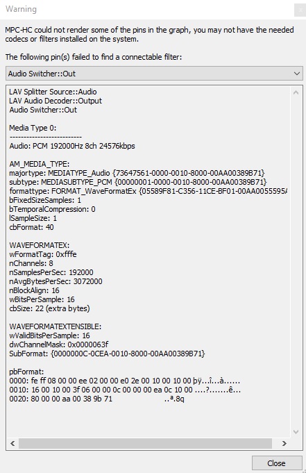

Shortly after writing the Post above, I tried watching 10 Cloverfield Lane in MKV with this new modified version of MPC-HC.
This was a movie I had previously SUCCESSFULLY watched in both the modified MPC-HC and Windows Media Player.
But now it has a message saying:
WARNING
MPC-HC could not render some of the pins in the graph, you may not have the needed codecs or filters installed on the system.
The following pin(s) failed to find a connection filter:
Audio Switcher: Out
LAV Splitter Source: Audio
LAVE Audio Decoder: Output
Audio Switcher: Out
Media Type 0:
Audio: PCM 192000hz 8ch 24576kbps
There is additional text that can be seen in the screenshot below
If anyone know why this is happen or how to fix it, please help out.

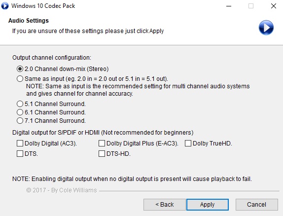

UPDATE: I have learned "why" the screenshot above with the "LAV Splitter" appears. ... I have also learned what caused the audio problems to return.
In the Tray in the lower-right corner, when you right-click on "Codec Pack Tray Menu," there are three audio options. Those audio options are:
Set Audio output to stereo
Set Audio output to same as input (5.1 -> 5.1)
Set Audio output to Digital S/PDIF or HDMI
Here is what happens when you choose each option.
I you select "Set Audio output to stereo" you hear the audio perfectly on your computer and you see the video perfectly on your computer from both MPC-HC and Windows Media Player.
If you select "Set Audio output to same as input (5.1 -> 5.1)" you will see the video perfectly in MPC-HC and Windows Media Player. However, there are apparently some movies for some reason when you will not hear the sounds from the Center Channel. For example, when I tried watching the MKV and MP4 of the movie Black Sheep in 5.0 surround sound, I was not able to hear the Center Channel of sound, which contained most of the voices. I thought this meant all movies would not allow me to hear the Center Channels; however, this was not the case. Other movies that used voices from the Center Channel allowed the voices to be heard from the stereo speakers of my computer. Also, what happened next was very unusual. ... In the movie Black Sheep, when the sound was "initially" set to the default 5.0, you could not hear the sounds from the Center Channel, which includes the voices. When you change the sound format to 2.0, you can hear the voices. This makes sense, because only two speakers are available on my computer. But this is where it gets weird - when I switched back to 5.0, the sounds (including voices) could then be heard from the Center Channel!
When you select "Set Audio output to Digital S/PDIF or HDMI" the screenshot above about the "LAV Splitter" appears on movies that use DTS sound as the default sound format. You will not be able to watch the movie on your computer. When you try to watch movies that have Dolby Digital as the default sound format, the LAV Splitter message will not appear. In fact, in the movie Black Sheep the Center Channel sounds, including voices, play fine on the computer with MPC-HC and Windows Media Player when this is selected - even though they do not when it is not selected. ... This option is the one where checks are placed the boxes when you select "Open Codec Settings (Run as administrator)".
If anyone can explain this, I would very much appreciate it. There are some serious inconsistencies and problems. We really need a technology that is more universal and works without problems.
