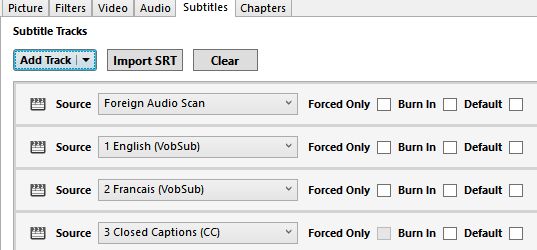

MakeMKV handles Subtitles perfectly well. But it seems to remove / fail to copy Closed Captions into the destination MKV file. Is there a setting I'm missing?
My girlfriend is deaf and relies heavily on CC's when watching TV, and on (english) Subtitles when watching movies. But often times, she prefers to view the CC's for a movie rather than the subtitles, because they offer extra descriptive context.
Handbrake will correctly see (and differentiate between) Subtitles and CC's in the same DVD, as shown in the attached screenshot (2 subtitles, and 1 CC in addition to the 'foreign audio scan', not covered in this discussion).
VideoLAN (VLC) will 'see' both the subtitles and CCs in the original DVD, and it will see both the subtitles and CCs in the MKV file processed by Handbrake, although it simply presents the CCs as another optional subtitle at the end of the subtitle list in this latter case.

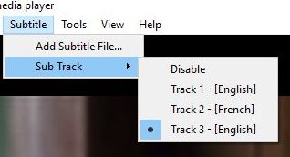

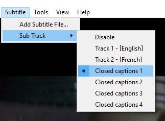

Thanks for the links! I'll do some more reading. What's interesting is, Handbrake seems to have no problem recognizing them (as seen in my screenshot above), and if you handbrake the DVD, the CCs are part of the output stream but - they appear to be 'converted' into 'subtitles'. Below are two screen shots from VLC that show what the 'Subtitle' menu shows for '50 first dates' as follows:
  1. when using VLC to play the DVD directly - note that VLC 'sees' 4 CC streams, while only the first one actually results in 'content'.
  2. when using VLC to play the MKV file created from the DVD by Handbrake, having selected all the subtitles and CCs. Now we see the same two subtitle options (1=English, 2=French) and a third English option that actually shows the 'CC' content (with modified font, etc).
I'm quite OK with the Handbrake way of 'converting' the CCs to Subtitles. My problem is ... I used Handbrake + AnyDVD for years to get my DVD collection onto disk, but cut over to Handbrake + MakeMKV when AnyDVD did the whole RedFox->SlySoft transition ... so anything I've converted in the last year or two has lost the CC stream without me realizing so I'm going to have to go back through and re-do everything.
