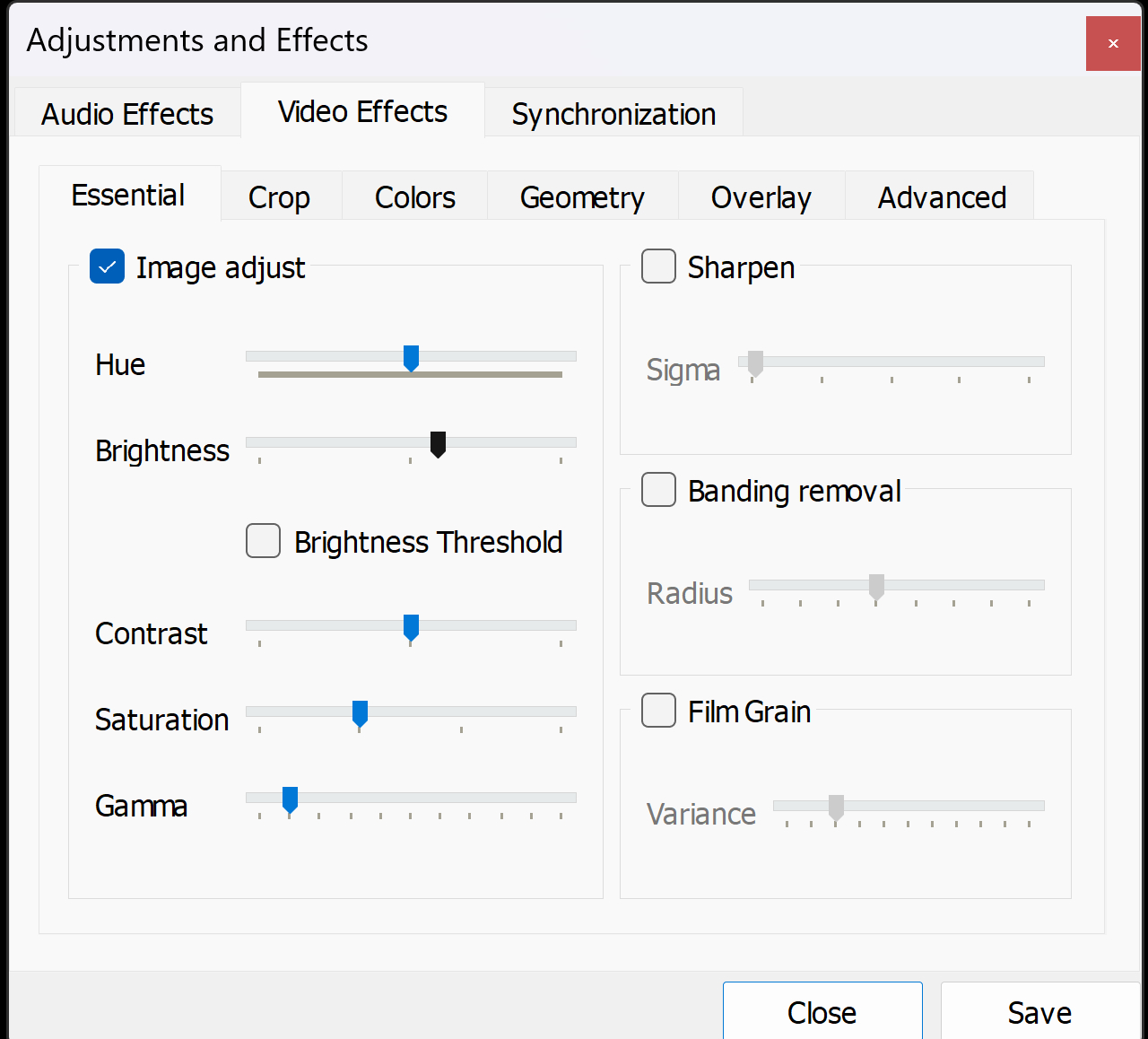

As the title states, I'm considering using another player for my mkv files. All my mkv files appear too dark in VLC and this seems to be a known issue. Anyone on here experiencing this also with mkv files from 4k blu rays? If so, is adjusting the brightness shown in the screenshot below the best way to get a better picture?
Also, the subtitles don't display properly in VLC when HRD is enabled in Windows. The subtitles appear black, and you can barely see them. This has been an issue for years. People have been complaining about it, yet nothing has been done. For these reasons, I was considering using another player but also wanted to get some feedback from others that use VLC.

I use MPC-HC with madVR enabled to watch any 4k material. The issue has to do with tone mapping( I believe this is the correct term if i'm wrong someone let me know) 4k material has HDR picture properties that VLC is not displaying correctly. This is why your stuff is looking dark and grey. MPC-HC fixes that up.

Can any VLC users comment on 4k mkv's appearing too dark? Is adjusting the brightness in VLC (provided screenshot) the best way to help with this apparent issue?

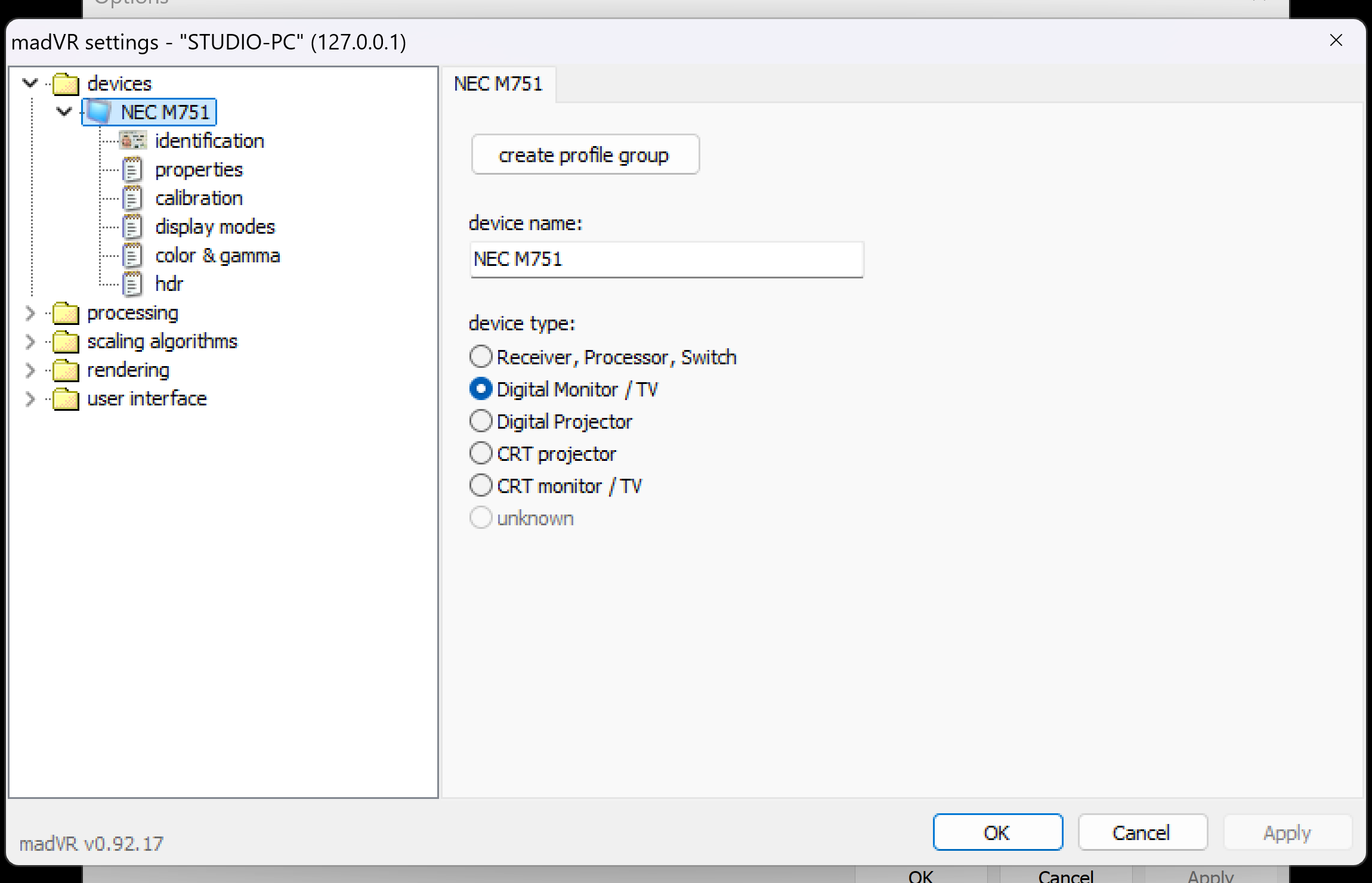

After you have to selected madVR as the video renderer, do you just use the defalut settings?
I want to compare the picture quality with VLC, how do you actually do this? I understand that a screenshot takes the digital image being sent to your display, not what your display actually looks like.

Thanks for letting me know. Apparently, VLC is aware of this and it's being looked into. In the meantime, you can adjust the brightness slightly in VLC.
You don't really install madVR. Well, you do but it's not a standard installation. You run the .exe and then move the folder to your program files on your C: drive. Then, for players that support madVR, you need to select it as the renderer in the players settings. After that, you have to configure madVR in the players settings.
However, there is no configuration guide that works for everyone with madVR. At least, not that I could find. Everyone's situation is different based on their display and what they are looking to achieve. If you do find some recommended settings, how do you know they are the best settings to use? There are A LOT of settings to mess with in madVR. For this reason, I choose to use a player that doesn't support madVR and instead uses it's own video renderer. Out of these options, I like VLC the best. Plus, I much prefer VLC in every other way than all the players I have tried.
