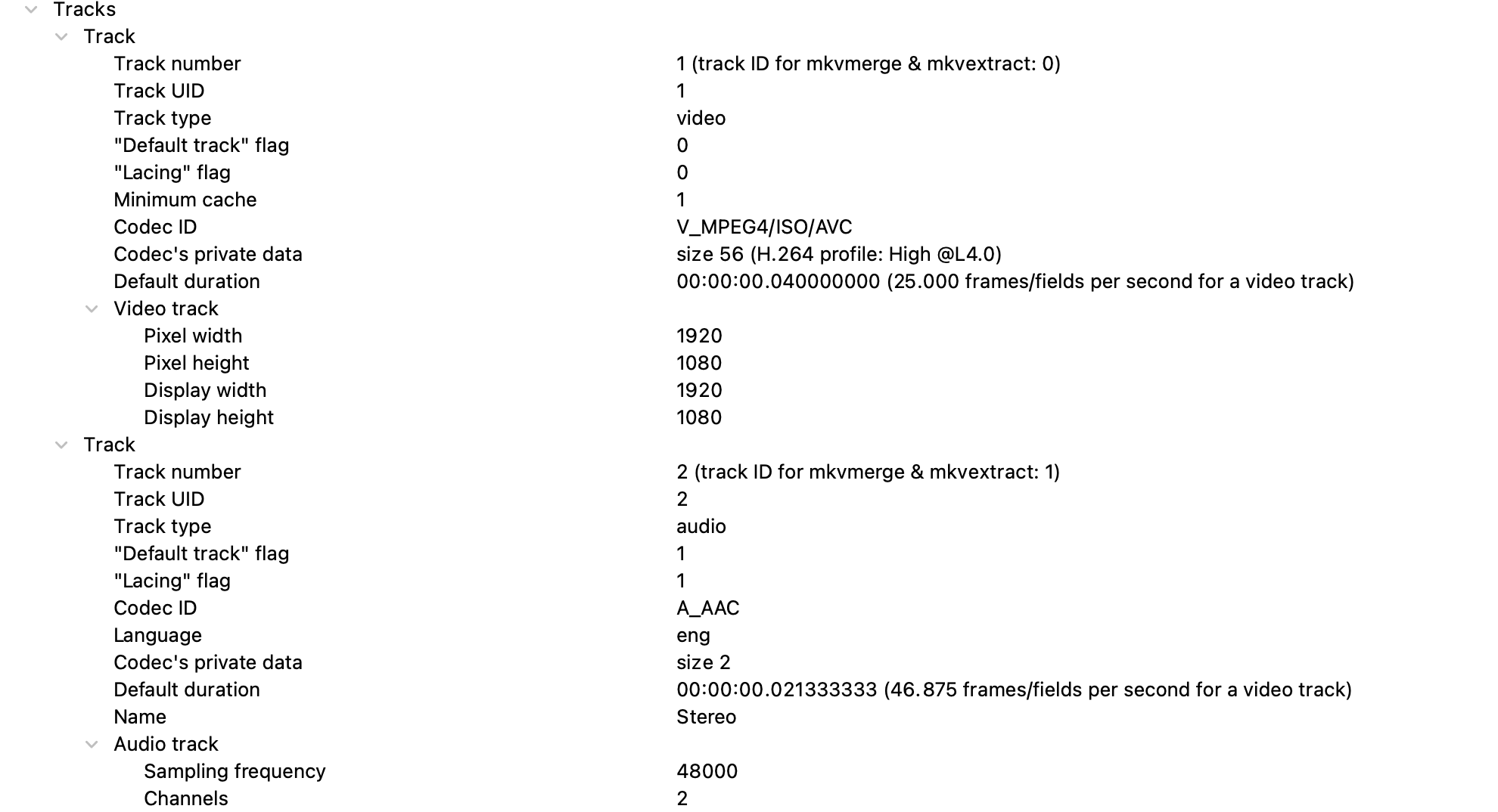

Bunter
Joined: Thu Sep 29, 2022 12:32 pm
Re: Need help correcting audio problems
Post by Bunter » Wed Oct 12, 2022 7:08 am
Don't apologise, you're helping so that's appreciated, thank you.
Attached is what is reported by the tracks using MKVToolNix.
Screenshot 2022-10-11 at 17.06.13.png (201.19 KiB) Viewed 11064 times
MKV sees reports that the audio is AAC. The container on the BD is m2ts, and MKV is the only thing I have that reads these (VLC won't play the BD at all nor the files, and ffmpeg cannot process these files). VLC reports the files have 0:00 duration. Other commerical BD work fine directly from the BD with VLC for me.
I do have a work around although it's a very dirty hack :D so if this is a problem no one has encountered before it probably is just my perculiar set up.
Bill
jinx100
Posts: 178
Post by jinx100 » Wed Oct 12, 2022 1:35 pm
That file information looks quite ordinary. Video - H264 and audio - AAC are common and should be easily decoded. You have only one audio track so no chance of picking the wrong track. The Freeview BR discs don't play with VLC but they must play in an ordinary BD disc player, right?
