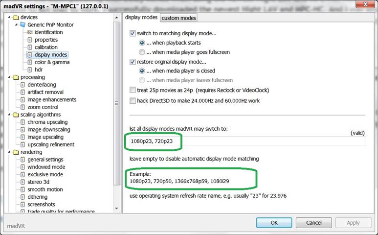

These are screen caps of the specific madVR settings for auto rate switch:
- CustomModss (Small).jpg (56.16 KiB) Viewed 28518 times
