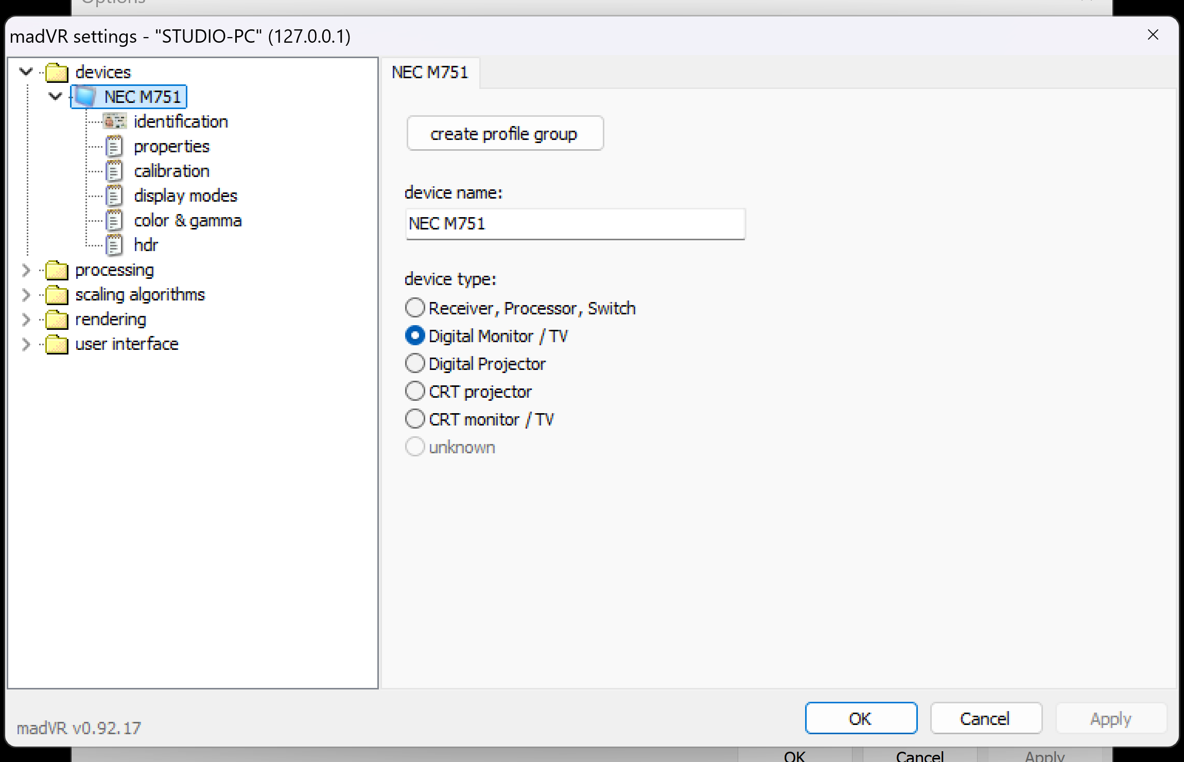

After you have to selected madVR as the video renderer, do you just use the defalut settings?
I want to compare the picture quality with VLC, how do you actually do this? I understand that a screenshot takes the digital image being sent to your display, not what your display actually looks like.
- Screenshot 2025-07-13 201236.png (73.82 KiB) Viewed 20591 times

You don't really install madVR. Well, you do but it's not a standard installation. You run the .exe and then move the folder to your program files on your C: drive. Then, for players that support madVR, you need to select it as the renderer in the players settings. After that, you have to configure madVR in the players settings.
However, there is no configuration guide that works for everyone with madVR. At least, not that I could find. Everyone's situation is different based on their display and what they are looking to achieve. If you do find some recommended settings, how do you know they are the best settings to use? There are A LOT of settings to mess with in madVR. For this reason, I choose to use a player that doesn't support madVR and instead uses it's own video renderer. Out of these options, I like VLC the best. Plus, I much prefer VLC in every other way than all the players I have tried.
