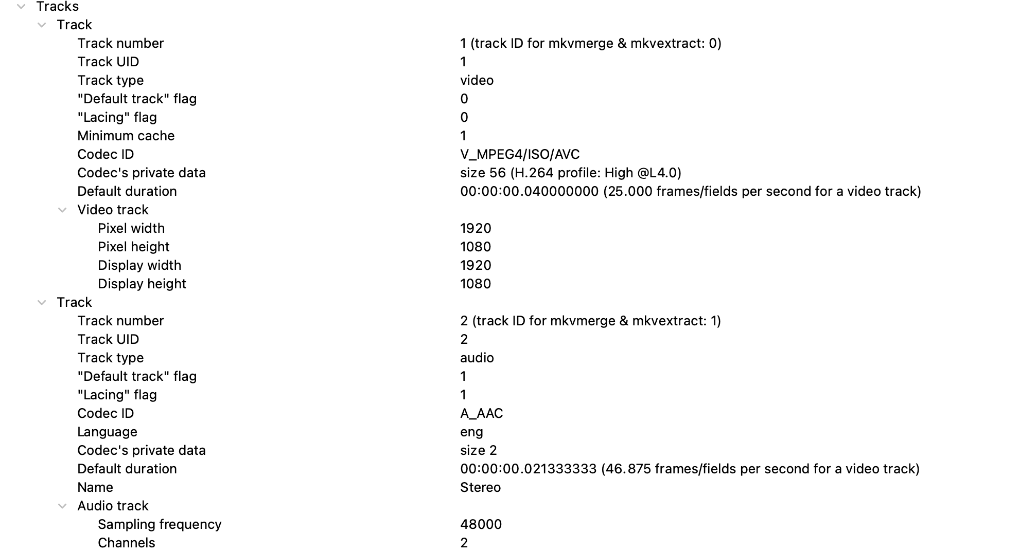

Attached is what is reported by the tracks using MKVToolNix.
Screenshot 2022-10-11 at 17.06.13.png (201.19 KiB) Viewed 11351 times
MKV sees reports that the audio is AAC. The container on the BD is m2ts, and MKV is the only thing I have that reads these (VLC won't play the BD at all nor the files, and ffmpeg cannot process these files). VLC reports the files have 0:00 duration. Other commerical BD work fine directly from the BD with VLC for me.

That file information looks quite ordinary. Video - H264 and audio - AAC are common and should be easily decoded. You have only one audio track so no chance of picking the wrong track. The Freeview BR discs don't play with VLC but they must play in an ordinary BD disc player, right?
