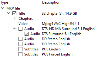

Hi, I'm experiencing the same issue within 1.15.2. I can confirm this was working well in 1.15.1, so I do believe it's a regression.
Track Selection.png (6.33 KiB) Viewed 38889 times
Source file:
Audio #1
Format : DTS ES XLL
Format/Info : Digital Theater Systems
Commercial name : DTS-HD Master Audio
Codec ID : A_DTS
Duration : 1 h 55 min
Bit rate mode : Variable
Bit rate : 3 834 kb/s
Channel(s) : 6 channels
Channel(s)_Original : 7 channels
Channel layout : C L R Ls Rs LFE Cb
Sampling rate : 48.0 kHz
Frame rate : 93.750 FPS (512 SPF)
Bit depth : 24 bits
Compression mode : Lossless
Stream size : 3.09 GiB (21%)
Language : English
Default : Yes
Forced : No
Destination file (extracted track):
Audio
Format : DTS ES XLL
Codec ID : A_DTS
Bit depth : 24 bits
Title : Surround 5.1
Language : English
Default : Yes
Forced : No

That's possible. I'm running 1.15.2 on Windows 10 (version 1909).
Source file has a DTS-HD MA audio track, and I'm selecting the child node to extract the DTS core as I've been able to do in prior versions. The only wildcard here is the new version which, according to the changelog, includes a "massive internal rewrite". So it makes sense that something may be out of whack.
