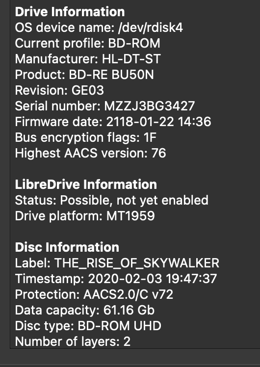

I am very new to ripping 4K Discs and have a MacOS, I've read lots of different things on here and don't know anything still:
My MacOS is what's shown in the image, and I listed what MakeMKV is telling me, all I did was plugged in the USB port into my computers USB port connector, it turns on fine and dandy, but I can't for the life of me figure out why it's giving errors when I attempt to rip the disc, well I know why, it wants me to flash it, but how? What would I use to flash this specific type? I just want it to work. I have MakeMKV working with DVDS & Blue-Ray using my other drive, but that drive didn't have 4K support. Please help.

Re: MakeMKV Using the Wbacon Drive
The first post in the Ultimate UHD Drives Flashing Guide thread is maintained and includes instructions on how to flash your drive and links to the necessary bits.
Flashing on the Mac involves using Terminal to issue the flashing commands.
