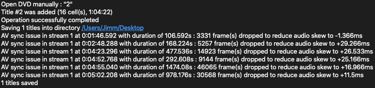

Thanks for the suggestion, it didn't resolve my issue but I think I'm getting closer... I was able to use the "Open DVD Files Manually" option and I could see it was title #2 that I needed (it's 1h 4m long, so that's the one). I selected it, attempted to rip it, but the resulting file was only 6m long... and I have this log, suggestions?
