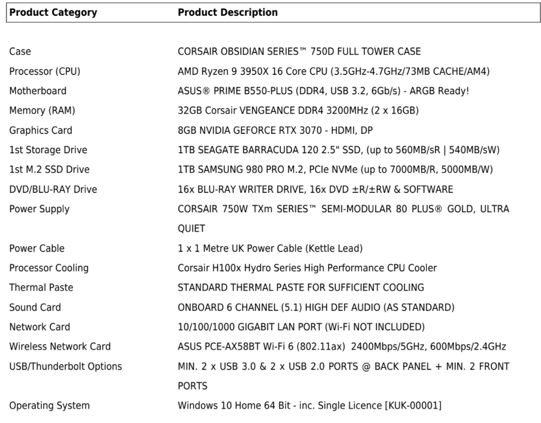

I have been happily using MakeMKV on my current windows PC which is a pretty powerful build as listed below and only one year old.
However i would like to move away from Windows and onto a more slimline PC form and more energy efficient as i have my PC running 24/7.
It has been a while since i ripped Blu Ray 4K on Mac and i wanted to ask a generic question whether all is working as it should and if you guys can recommend any external Blu Ray 4K drives that can be modified with custom firmware to decrypt 4K discs.
This is my current set up which works flawlessly at the end of this message and i just want to replace it with a base spec Mac Studio Max. Hoping to sell my current set up for as much as the Mac Studio or close enough. Am i sacrificing too much power? My most intensive task is re-encoding the 4K rips via Handbrake to and acceptable mid to high quality while utilising the built in CUDA hardware encoder on the Graphics card which can re-encode a 4K file in a 40-50 minutes sometimes less depending on settings. Plex is also running on this machine. I am not a gamer!

Huge downgrade apple is not magic your going form 16 cores to 10 you won't be able to use the nvidia encoder and I'm not sure if handbreak can use the hardware encoder on Mac.

Thanks @billycar11Billycar11 wrote: ↑Tue Mar 22, 2022 11:51 amHuge downgrade apple is not magic your going form 16 cores to 10 you won't be able to use the nvidia encoder and I'm not sure if handbreak can use the hardware encoder on Mac.
I was half expecting this reply! Yeah it does sound like i am good where i am as it is. My build above was build with the view to 'keep' for at least 5-8 years just like the one it replaced from 2013 last year.
