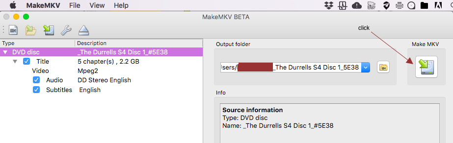

At the end, I am presented a hierarchy of the "DVD disc" with one 5-chapter Title (checked). (see attached screenshot) When I click the Make MKV button to the right it creates a single file named "title_t00.mkv" in my designated target location.
When I play the video it is a correctly-rendered video but only one of the 3 titles on the DVD source.

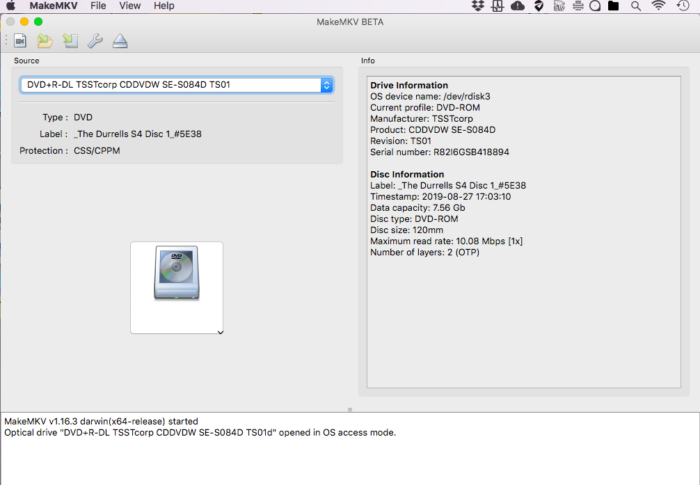

I don't have a left hand menu. This is what I see at launch:
at startup.png (126.59 KiB) Viewed 9301 times
