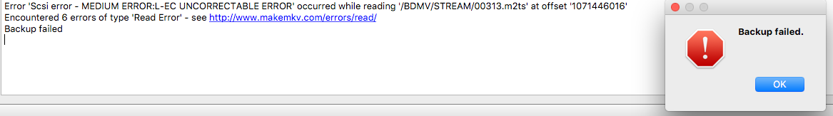

Thanks again to all who replied or thought about replying. This is a screenshot of the error message.

I actually see the same behavior. I used to have a 90% success rate a couple of years ago, now I am down below 50%. And these are with brand new discs. I guess it could be my drive failing, so I will be looking back to this thread when I upgrade, to see if there's something else going on. At least Woodstock mentioned in another thread that my errors indicated that the problem was with dual layer discs.

The problem with doing "backups" vs. open the disk and save each title as an MKV file, is that ANY read failure causes the entire backup to be tagged as "Failed".
Saving as individual files, only titles where there was a read error fail.
Yorgo posted If you're experiencing rip errors, please read here first! as a consolidated checklist of things that cause failures on fresh-from-the-package disks.
Yes, it is possible you are having a drive issue. But the overwhelming probability is simply a contaminated disk. Contaminated disks can affect the focus of the laser trying to move between layers.
My solution, besides cleaning? I have 3 internal BD drives (in different computers), 1 external BD drive, and 2 external DVD drives. It makes it a lot easier to figure out if an error is drive-related or disk-related.

I washed the poor disk with mild soap and put it through its paces again in my new BluRay reader. This time I made note of the read speeds. Through the first 25% of the disk, read speeds were at 8.5 M/s. Then for the next 25%, they zigzagged wildly, ending up in the hundreds of K/s, at which point I shut down the backup. Clicking on the red hand did nothing, so I shut down the program with Command-Option-Escape.
I know nothing about BluRays, but the idea that some of them have two layers and the second layer is hard to read makes sense.
There was a mention of a BluRay reader that plugs into a different power source than the computer, and I wonder if somebody has a comment on that.

If it is plugged into a USB3 port, it should have enough power. It's USB2 ports that tend to have power issues.
Speed issues generally appear in the log as a "tracking" or "seek" error, followed by messages about the device not being ready or available, eventually coming back online for a while.
This can ALSO happen with some drives that stop responding to the operating system while they're trying to read a sector that has an error.
