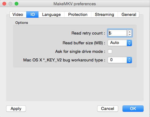

I have set 5 retrys. (screenshot of I/O settings below). I think these are default.
What would you suggest I try? 10, 20 or more?
- I/O settings
- Screen Shot 2015-11-02 at 8.47.12 PM.png (41.31 KiB) Viewed 13542 times

I personally only go beyond 5 for special circumstances, but I've gone as high as 25 when I had an issue with a disk that I'd already had replaced twice. The main result is that you won't know about a bad spot for a long time, as it retries.
