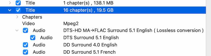

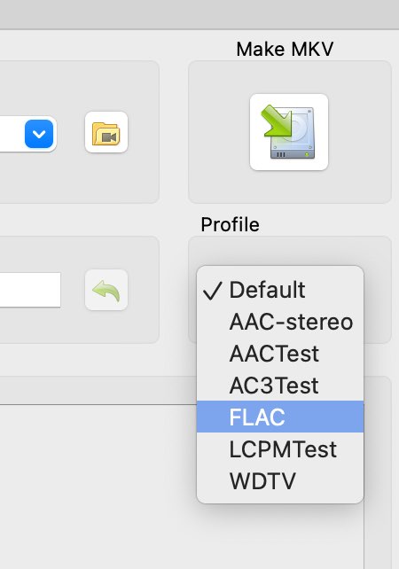

Does it have to be LPCM or would FLAC work? I ask because the FLAC conversion profile is built in by default, making it easy to do on-the-fly audio conversions.
In any case, you need to Export Mode enabled in MakeMKV. (MakeMKV Preferences -> General Tab -> Expert Mode checkbox)
Then, when you've got a disc or a backup loaded in MakeMKV, on the right, there's a dropdown box labeled Profile.
Select FLAC.
If you click the little '>' next to the movie in the box on the left, you should then see the audio track show it is going to be converted to FLAC.
If it really has to be LPCM, then a custom conversion profile has to be added before it can be selected in the profile dropdown box.

The FLAC conversion seems to have split the audio tracks into two, so I don't think FLAC is the solution here.

The lossless audio formats DTS-HD Master Audio and Dolby TrueHD both have this notion of a 'lossy core' that's used as a fallback mechanism for playback systems that can't process their respective lossless audio stream. MakeMKV splits the lossy core out into its own track. It does this by default regardless of conversion profile used. By default, the FLAC conversion profile only converts the lossless audio into FLAC.
If you only wanted the FLAC converted audio track you could uncheck the 'lossy core' when you rip. That will probably make the resulting .mkv file less portable, since it would only work on systems that can play FLAC. The resulting file would be a bit smaller, however.
Since most playback systems have a way to let the user pick which audio track is used during playback, I don't think leaving the lossy core in the resulting .mkv is much of a concern.

The same thing converted to LCPM using my custom conversion profile I was playing around with many moons ago.

My conversion profile:
<?xml version="1.0" encoding="utf-8"?>
<profile>
    <!-- profile name - Default -->
    <name lang="eng">LCPMTest</name>
    <!-- Common MKV flags -->
    <mkvSettings
        ignoreForcedSubtitlesFlag="true"
        useISO639Type2T="false"
        setFirstAudioTrackAsDefault="true"
        setFirstSubtitleTrackAsDefault="true"
        setFirstForcedSubtitleTrackAsDefault="true"
        insertFirstChapter00IfMissing="true"
    <outputSettings name="lpcm" outputFormat="LPCM-raw">
        <description lang="eng">Save as raw LPCM</description>
    </outputSettings>
    <trackSettings input="DTSHDMA-multi">
        <output outputSettingsName="lpcm"
                defaultSelection="$app_DefaultSelectionString,+sel:true">
        </output>
    </trackSettings>
</profile>
As the link to conversion profiles above says, the custom conversion profiles have to be named appropriately and put into the MakeMKV data directory, which is defined in MakeMKV's preferences.
