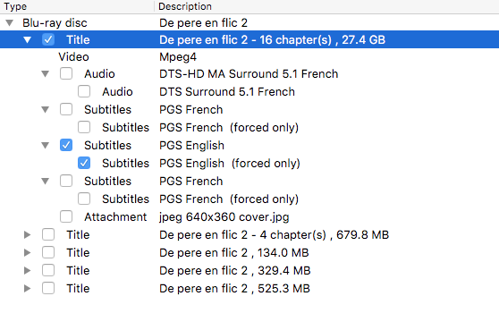

For the second time now, I realize, after finishing up the conversion with HandBrake that the audio track is no where to be found (thus no sound in the movie file)
When going back to MakeMKV, you clearly see that the program didn't checked any Audio tracks by default, like it normally does all the time.
(see attached)
Of course it's easy to check it myself, but I never had to do that before that.
Any reason that would explain that new behaviour

- Screen Shot 2017-12-22 at 10.45.19 AM.png (71.03 KiB) Viewed 15023 times

If you are using Expert mode (Preferences->General), you can check the default selection rule on the Advanced tab. We need to see that rule, and whether or not you have selected a preferred language (Preferences->Language, Preferred language).

Indeed I set it up to
Interface Language: Eng
Prefered language: Eng
but the problem was that only French was on the BD!
That might explain a few things!
Now I've set them to :
Prefered language: None
So for future French movies (and setup that way), should I expect MakeMKV will select the first default language, thus in this case French?

Re: Audio track not automatically selected on some BD
Actually, MakeMKV will default to selecting all languages now.
