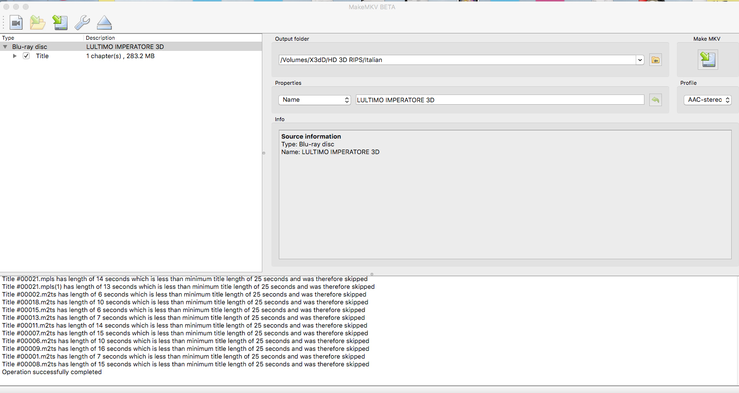

I have an issue with this disc as well. Mac, MakeMkv 1.14.4, Opens disc and shows only one file of 283.2 mb which copies fine but it's just the title.
Anyone?
This is the Italian 3d disc.
Anyone?
