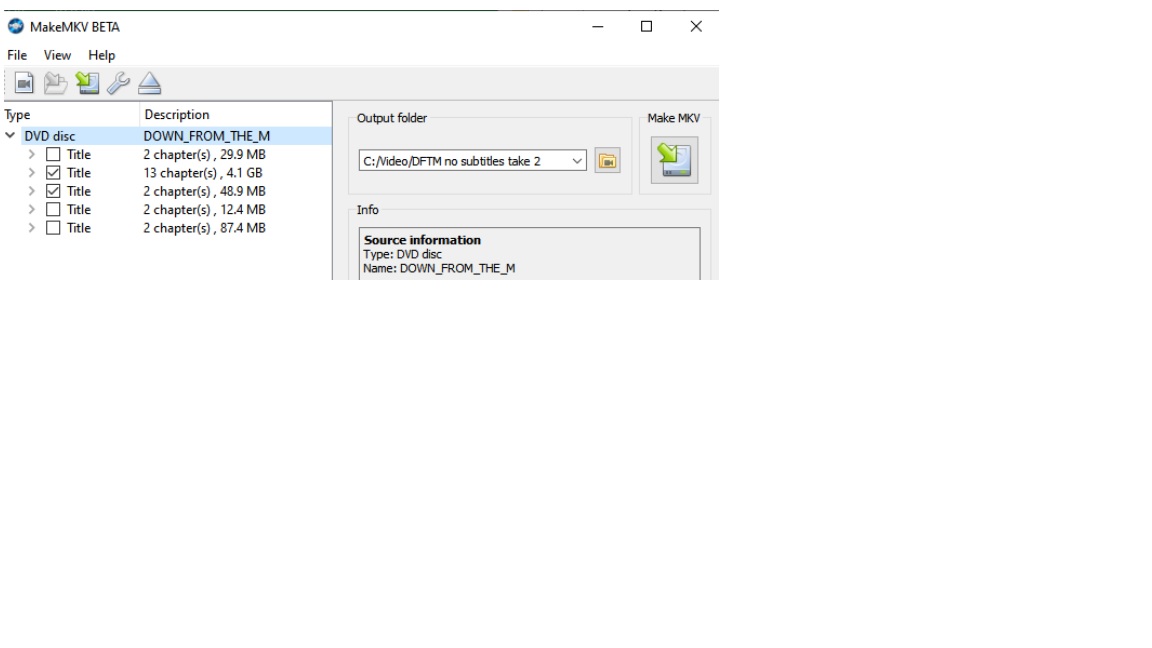

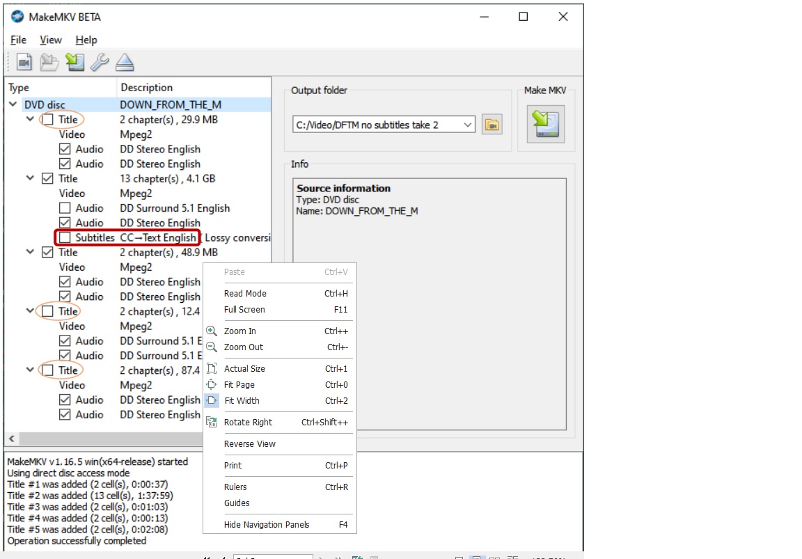

Re: How to set subtitles off >> SOLVED
After MakeMKV scans the disc we see something like this (with all the Title boxes checked):
We need to click on the right arrow to the left of the Title box, opening many options.
I hope the attachments view correctly. Not familiar with adding attachments like this. But the instructions work, of that I'm sure.
-- Steve
