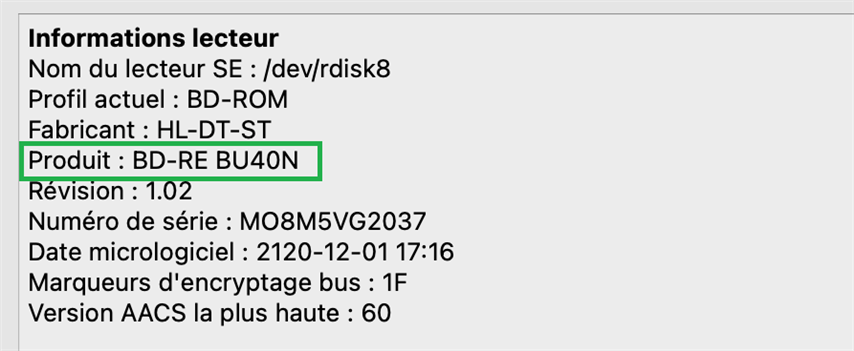

Bonjour,
Impossible de ripper mon blu-ray UHD "The Revenant"; voici le message :
Capture d’écran 2023-02-07 à 18.14.40.png (141.86 KiB) Viewed 6150 times
J'ai entendu parler de patch, que dois-je faire?
Merci

Guytoon
Joined: Mon Feb 06, 2023 1:07 pm
Re: ripping impossible
#3 Post by Guytoon » Tue Feb 07, 2023 6:24 pm
My reader is a Archon UHD...

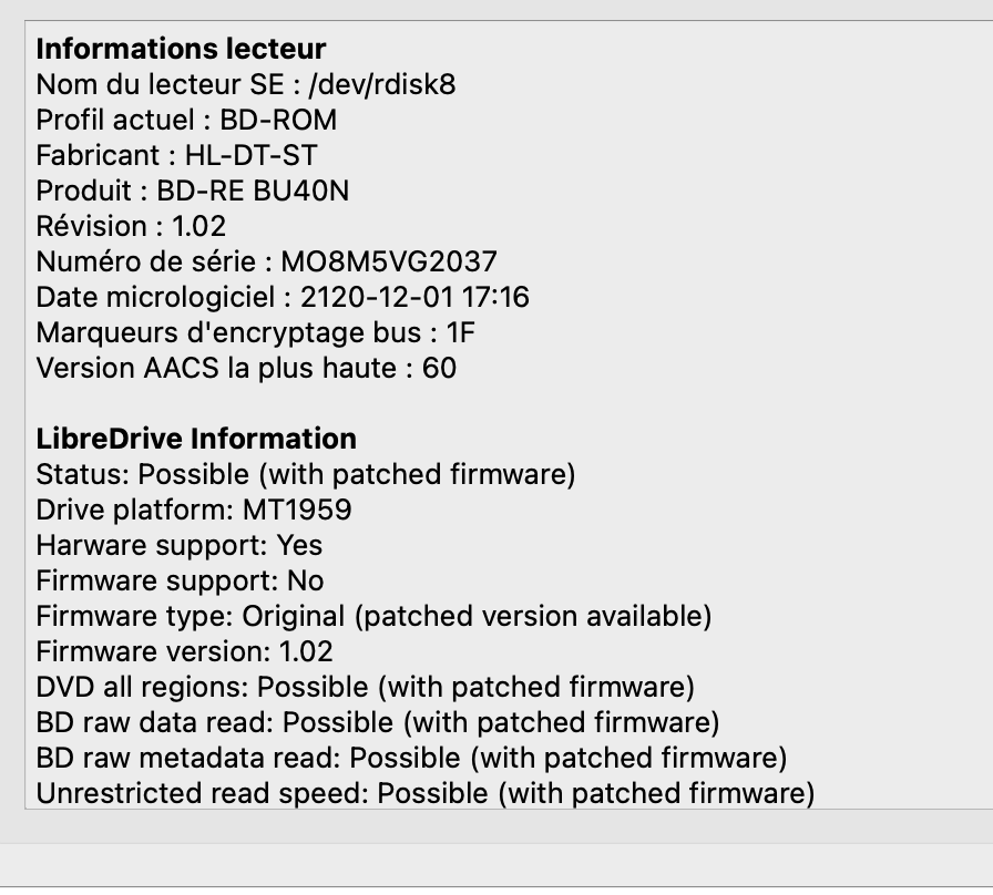

#4 Post by d00zah » Tue Feb 07, 2023 7:19 pm
Capture d’écran 2023-02-07 à 18.14.40 (Small).png (77.34 KiB) Viewed 6138 times
FW v1.02 is on the 'encrypted' list, so use the command line example containing 'enc'.
