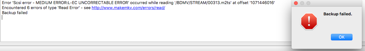

Thanks again to all who replied or thought about replying. This is a screenshot of the error message.
Screen Shot 2018-06-23 at 11.48.03 PM.png (38.26 KiB) Viewed 30170 times

I actually see the same behavior. I used to have a 90% success rate a couple of years ago, now I am down below 50%. And these are with brand new discs. I guess it could be my drive failing, so I will be looking back to this thread when I upgrade, to see if there's something else going on. At least Woodstock mentioned in another thread that my errors indicated that the problem was with dual layer discs.
Posts: 10864
Re: MakeMKV now fails to complete BluRay backup every time
#8 Post by Woodstock » Mon Jun 25, 2018 1:48 pm
The problem with doing "backups" vs. open the disk and save each title as an MKV file, is that ANY read failure causes the entire backup to be tagged as "Failed".
Saving as individual files, only titles where there was a read error fail.
Yorgo posted If you're experiencing rip errors, please read here first! as a consolidated checklist of things that cause failures on fresh-from-the-package disks.
Yes, it is possible you are having a drive issue. But the overwhelming probability is simply a contaminated disk. Contaminated disks can affect the focus of the laser trying to move between layers.
My solution, besides cleaning? I have 3 internal BD drives (in different computers), 1 external BD drive, and 2 external DVD drives. It makes it a lot easier to figure out if an error is drive-related or disk-related.

If it is plugged into a USB3 port, it should have enough power. It's USB2 ports that tend to have power issues.
Speed issues generally appear in the log as a "tracking" or "seek" error, followed by messages about the device not being ready or available, eventually coming back online for a while.
This can ALSO happen with some drives that stop responding to the operating system while they're trying to read a sector that has an error.
