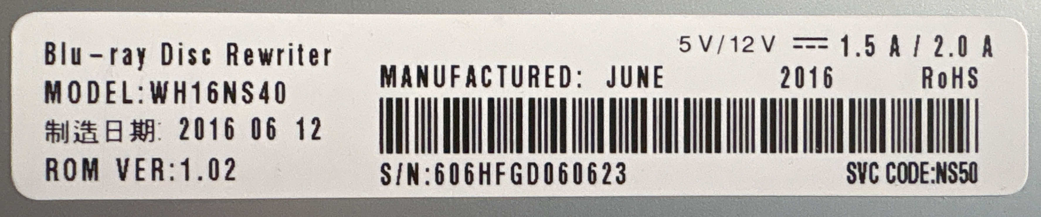

My LG Blu-ray Disc drive (LG WH16NS40) seems to have died. I thought I'd check with the collective smart people to get opinions. I purchased this drive from OWC back in late Dec'16. It came with the 1.02 firmware which I figured out from these forums have to upgrade to 1.03.

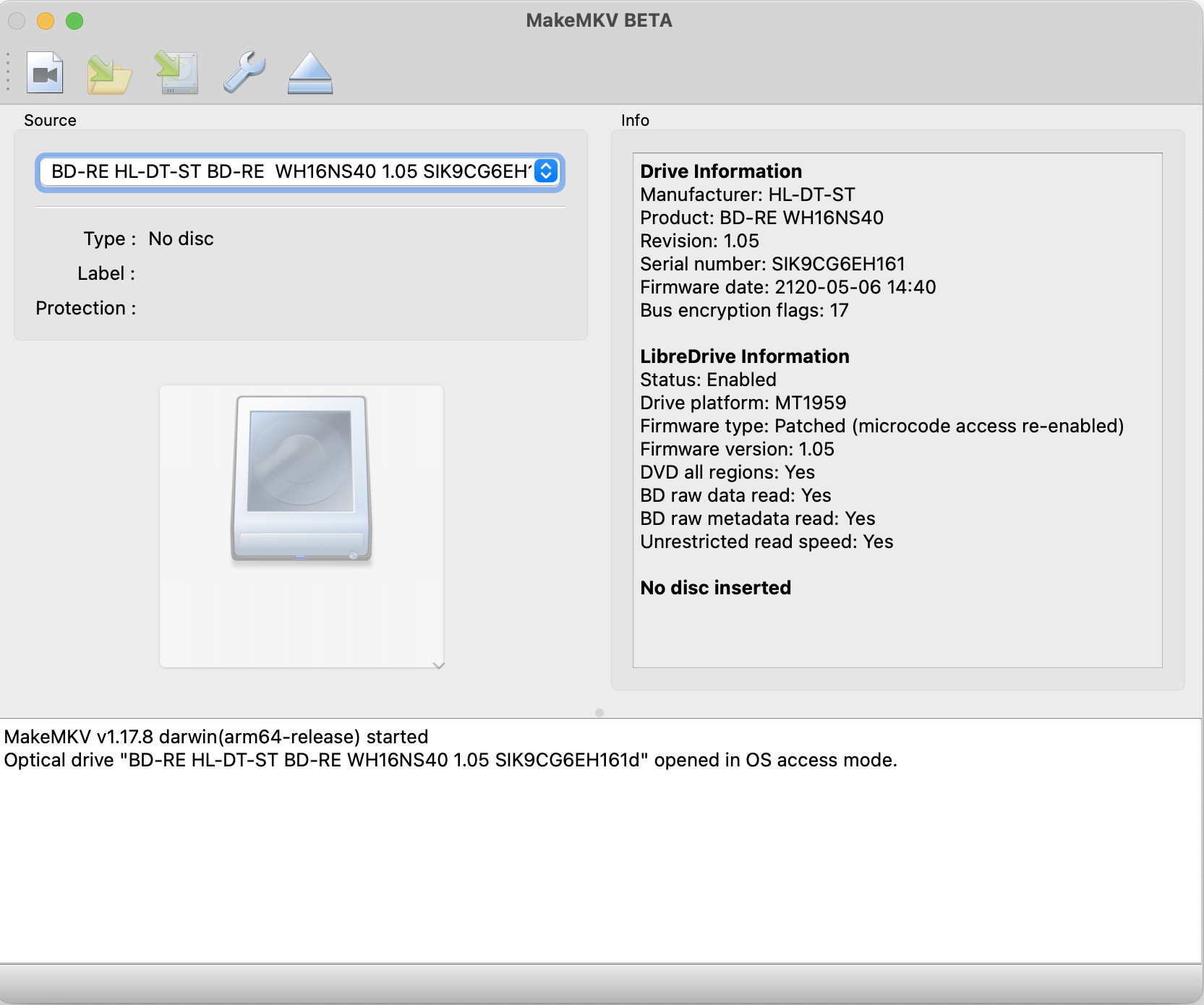

I have tried to re-flash the LG drive with 1.05, 1.02 and 1.03. No change. I tried the 1.01 restore but I have not successfully flashed it. I've tried using "main, enc and full" when flashing with no results. The only changes I can think of since it last worked was a new TB4 hub and the update from macOS from 15.1 -> 15.2. I tried plugging the drive direct to the iMac with 2 different Apple USC-C to A adapters as well as another I 3.0 one I purchased from amazon. No luck.

- Screenshot 2025-01-19 at 13.12.38.png (262.43 KiB) Viewed 7114 times
- ROM VER1.02.jpeg (689.62 KiB) Viewed 7114 times

The Ultimate UHD Drives Flashing Guide says your drive should be on the WH16NS60 1.02MK firmware. This is considered the best firmware for the internal LG drives.
In any case, even without MakeMKV running, if you put a DVD in an optical drive, your Mac should 'see' it and mount it. It'll show up in Finder under Locations in the sidebar or wherever just like when you plug in an external drive or USB stick.

yeah, the 1.05 is where I stopped flashing and took a screenshot to post. It's back on 1.02MK (WH16NS60) and still doesn't work. It's not a makeMKV problem. It just won't mount any disk now so it's a hardware and/or macOS 15.2 issue. Curiously, it worked for over a year on 1.05.
