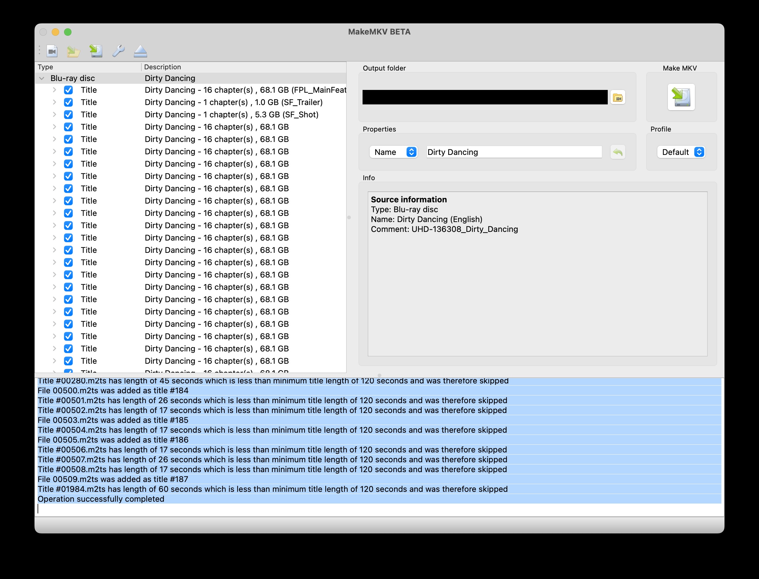

I'm not sure how to tell. MakeMKV can load the track list.
MakeMKV v1.17.8 darwin(arm64-release) started
Debug logging enabled, log will be saved as /Users/davidarthur/MakeMKV_log.txt
Optical drive "BD-RE PIONEER BD-RW BDR-S13U 1.03 DIDL302009UCd" opened in OS access mode.
Using LibreDrive mode (v01.0 id=DFE22909F92F)
Using direct disc access mode
Using Java runtime from /Library/Java/JavaVirtualMachines/jdk-21.jdk/Contents/Home/bin/java
Title #00001.mpls has length of 10 seconds which is less than minimum title length of 120 seconds and was therefore skipped
Title #00002.mpls has length of 5 seconds which is less than minimum title length of 120 seconds and was therefore skipped
Title #00003.mpls has length of 95 seconds which is less than minimum title length of 120 seconds and was therefore skipped
Title #00004.mpls has length of 8 seconds which is less than minimum title length of 120 seconds and was therefore skipped
Title #00011.mpls has length of 8 seconds which is less than minimum title length of 120 seconds and was therefore skipped
Title #00020.mpls has length of 12 seconds which is less than minimum title length of 120 seconds and was therefore skipped
Title #00115.mpls has length of 45 seconds which is less than minimum title length of 120 seconds and was therefore skipped
Title #00116.mpls has length of 5 seconds which is less than minimum title length of 120 seconds and was therefore skipped
Title #00117.mpls has length of 45 seconds which is less than minimum title length of 120 seconds and was therefore skipped
File 00706.mpls was added as title #0
File 00823.mpls was added as title #1
File 00824.mpls was added as title #2
File 00016.mpls was added as title #3
File 00027.mpls was added as title #4
File 00030.mpls was added as title #5
File 00032.mpls was added as title #6
File 00038.mpls was added as title #7
File 00041.mpls was added as title #8
File 00043.mpls was added as title #9
File 00047.mpls was added as title #10
File 00048.mpls was added as title #11
File 00061.mpls was added as title #12
File 00062.mpls was added as title #13
File 00067.mpls was added as title #14
File 00071.mpls was added as title #15
File 00072.mpls was added as title #16
File 00073.mpls was added as title #17
File 00074.mpls was added as title #18
File 00078.mpls was added as title #19
File 00081.mpls was added as title #20
File 00084.mpls was added as title #21
File 00085.mpls was added as title #22
File 00086.mpls was added as title #23
File 00090.mpls was added as title #24
File 00091.mpls was added as title #25
File 00095.mpls was added as title #26
File 00099.mpls was added as title #27
File 00100.mpls was added as title #28
File 00103.mpls was added as title #29
File 00106.mpls was added as title #30
File 00109.mpls was added as title #31
File 00113.mpls was added as title #32
File 00131.mpls was added as title #33
File 00136.mpls was added as title #34
File 00143.mpls was added as title #35
File 00144.mpls was added as title #36
File 00146.mpls was added as title #37
File 00151.mpls was added as title #38
File 00152.mpls was added as title #39
File 00154.mpls was added as title #40
File 00155.mpls was added as title #41
File 00162.mpls was added as title #42
Title 00167.mpls is equal to title 00067.mpls and was skipped
File 00175.mpls was added as title #43
File 00178.mpls was added as title #44
File 00186.mpls was added as title #45
Title 00187.mpls is equal to title 00113.mpls and was skipped
File 00195.mpls was added as title #46
File 00199.mpls was added as title #47
File 00210.mpls was added as title #48
File 00230.mpls was added as title #49
File 00232.mpls was added as title #50
Title 00233.mpls is equal to title 00151.mpls and was skipped
File 00239.mpls was added as title #51
File 00252.mpls was added as title #52
File 00255.mpls was added as title #53
Title 00256.mpls is equal to title 00091.mpls and was skipped
File 00257.mpls was added as title #54
File 00260.mpls was added as title #55
File 00266.mpls was added as title #56
File 00267.mpls was added as title #57
File 00273.mpls was added as title #58
File 00287.mpls was added as title #59
File 00292.mpls was added as title #60
File 00297.mpls was added as title #61
File 00299.mpls was added as title #62
File 00300.mpls was added as title #63
File 00302.mpls was added as title #64
File 00307.mpls was added as title #65
File 00308.mpls was added as title #66
File 00310.mpls was added as title #67
File 00319.mpls was added as title #68
File 00321.mpls was added as title #69
File 00325.mpls was added as title #70
File 00329.mpls was added as title #71
File 00334.mpls was added as title #72
File 00338.mpls was added as title #73
Title 00341.mpls is equal to title 00074.mpls and was skipped
File 00342.mpls was added as title #74
File 00343.mpls was added as title #75
File 00346.mpls was added as title #76
Title 00351.mpls is equal to title 00030.mpls and was skipped
File 00352.mpls was added as title #77
File 00364.mpls was added as title #78
File 00365.mpls was added as title #79
File 00371.mpls was added as title #80
File 00380.mpls was added as title #81
File 00390.mpls was added as title #82
File 00395.mpls was added as title #83
File 00396.mpls was added as title #84
File 00397.mpls was added as title #85
File 00398.mpls was added as title #86
File 00404.mpls was added as title #87
File 00410.mpls was added as title #88
Title 00413.mpls is equal to title 00257.mpls and was skipped
File 00415.mpls was added as title #89
File 00427.mpls was added as title #90
File 00431.mpls was added as title #91
File 00432.mpls was added as title #92
File 00435.mpls was added as title #93
File 00437.mpls was added as title #94
File 00439.mpls was added as title #95
File 00444.mpls was added as title #96
Title 00446.mpls is equal to title 00032.mpls and was skipped
File 00454.mpls was added as title #97
Title 00456.mpls is equal to title 00043.mpls and was skipped
File 00459.mpls was added as title #98
File 00462.mpls was added as title #99
Title 00469.mpls is equal to title 00103.mpls and was skipped
File 00476.mpls was added as title #100
File 00479.mpls was added as title #101
File 00483.mpls was added as title #102
File 00485.mpls was added as title #103
File 00490.mpls was added as title #104
File 00507.mpls was added as title #105
File 00508.mpls was added as title #106
File 00512.mpls was added as title #107
File 00513.mpls was added as title #108
Title 00514.mpls is equal to title 00162.mpls and was skipped
Title 00523.mpls is equal to title 00410.mpls and was skipped
File 00526.mpls was added as title #109
File 00529.mpls was added as title #110
File 00531.mpls was added as title #111
File 00544.mpls was added as title #112
File 00580.mpls was added as title #113
File 00587.mpls was added as title #114
File 00596.mpls was added as title #115
File 00598.mpls was added as title #116
File 00600.mpls was added as title #117
File 00601.mpls was added as title #118
File 00602.mpls was added as title #119
File 00604.mpls was added as title #120
File 00605.mpls was added as title #121
File 00606.mpls was added as title #122
File 00607.mpls was added as title #123
File 00613.mpls was added as title #124
File 00615.mpls was added as title #125
File 00629.mpls was added as title #126
File 00631.mpls was added as title #127
File 00645.mpls was added as title #128
File 00671.mpls was added as title #129
File 00672.mpls was added as title #130

I do notice that the track listing is a bit weird.
Screenshot 2025-01-17 at 12.06.52 PM.jpg (858.46 KiB) Viewed 9344 times
How can I check if the drive supports UHD? It's a Pioneer BDR-S13U

No luck after using a new cord. I guess this is an OS issue :-/
Has anyone had luck with this drive and ripping UHD on Mac OS?
Posts: 4429
Re: Disc disappearing half way through rip
mumrah wrote:
Sun Jan 19, 2025 11:17 pm
I rip on macOS all the time. My Pioneer drives are in Vantec cases instead of the OWC cases, although I have two non-Pioneer drives in OWC cases. Either case should be fine.
Are you sure you want to rip dozens of copies of the movie?
Does it work if you make a decrypted backup of the disc? (click the icon of the yellow folder with the green arrow on the first screen of MakeMKV) Once a backup is made, you can open that backup with MakeMKV and create .mkv files without having to read from the optical disc again.

Post by mumrah »
Turns out this was a damaged disc. I have since tried other UHD discs and was able to rip with no problems.
