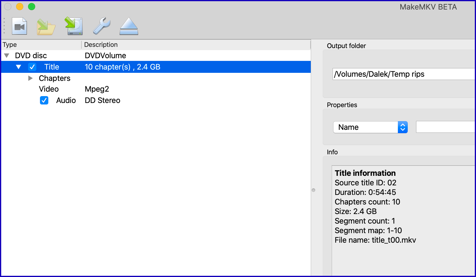

With this particular DVD set when it has finished the decrypting (and shows 'Operation successfully completed' in the progress window) and it shows the title options (ie where you can select which titles to extract) it only shows one title. I did hope that the one title might contain the three episodes stuck together but unfortunately it's just the first title of the three on the disc.
Callan DVD titles.jpg (251.33 KiB) Viewed 7658 times
