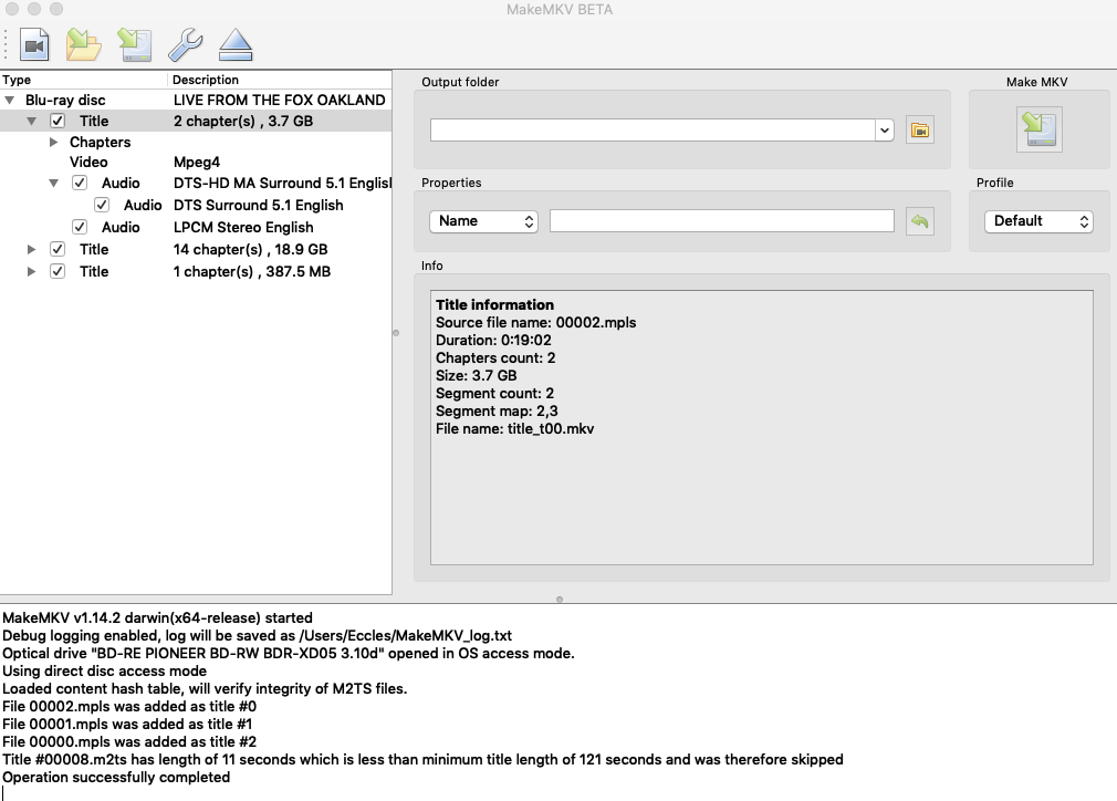

MakeMKV (1.14.2) reads the bluray fine but "Backup disc", "Save selected titles", and "Make MKV" buttons are dimmed. This is on Mac OS 10.14.2. Any ideas on what the issue is? Screenshot and debug log attached.

At the point you're at in that screenshot, "Backup" is already off the table.
And, with nothing in the "Output folder" box, MakeMKV has nothing to do, so the other buttons are dim.
