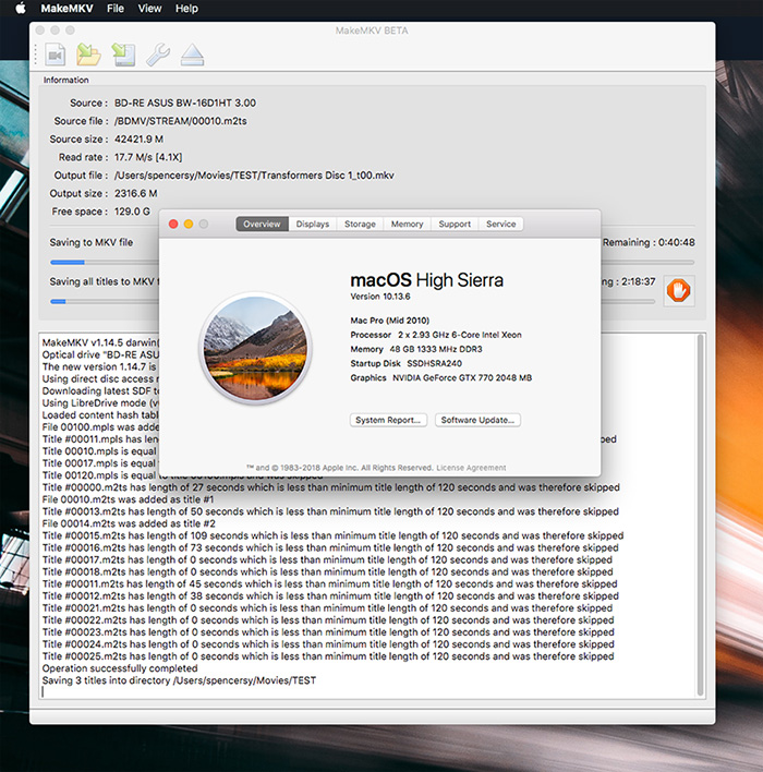

Sorry to hear about your problem. I’m on High Sierra 10.13.6 and luckily, my ASUS BW-16D1HT drive works fine and able to rip 4K UHDs and standard blu-rays. Direct disc playback also works. My Mac Pro is the same model as your Mac Pro. My Asus is the same model like yours. Not sure if this will fix the problem, disconnect your blu-ray drives, than you can try Resetting the PRAM, https://support.apple.com/en-us/HT204063. You may also try booting to your Recovery HD, restart your Mac and at the keyboard, press down CMD+R. Once in Recovery Hd, launch Disk Utility and run “First Aid” on your Mojave HD.
The firmware SMC Version (system): 1.39f11 is Not the firmware created by High Sierra It's your BOOT-ROM MP51.0089.B00 that High Sierra updated.
Good Luck

Hi Halfsquatch. The SMC version of my 2010 Mac Pro is 1.39f11 All 2010 Mac Pros have this same SMC version regardless of the OS version I have 2 Asus BW-16DHt, the firmware of my second Asus is 3.01 and also works fine under High Sierra. I don't think the firmware of the drive is related to the reading BDs problem in my opinion. Try testing various blu-rays, wipe them with fibre cloth to test further. Not a tech guy but if it is an OS problem, then all your drives cannot read any discs.
