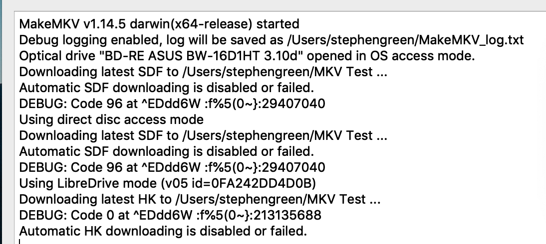

For the last week or two, every time I launch MakeMKV or insert a new BD disc, it hangs on downloading "latest SDF," and then says "automatic SDF downloading is disabled or failed." From there however, it would read and decrepit ordinary BD discs just fine.
I've just purchased a modified UHD drive from one of our fellow board members (highly recommended!) and when I try to decrypt a UHD disc, SDF and HK downloading fails, MakeMKV suffers a fatal error and crashes. It still works just fine (other than the download failure) on BD discs.
I've looked at MakeMKV's settings, and "allow contacting web server for updates" is checked. MakeMKV.com is whitelisted in Pi-Hole, and the app has permission to accept connections in macOS's built-in firewall.
What am I doing wrong, and how do I fix it?
SDF Fails to Download, MakeMKV fatal error opening UHDs
- Screen Shot 2019-09-23 at 5.50.11 PM.png (153.11 KiB) Viewed 29804 times

Re: SDF Fails to Download, MakeMKV fatal error opening UHDs
No, the problem is on the MakeMKV server end - the domain that was being used has (probably) expired, so you cannot reach it anymore. Only Mike can fix that.
In the mean time, the manual download is the only working method (link earlier in the topic).
For all the operating systems that MakeMKV runs on, the hosts file vary slightly.
Linux uses "/etc/hosts", and the file will probably be owned by root.
Windows puts it in "%WINDIR%\system32\drivers\etc\hosts", but you might have a problem getting notepad to see it or open it because there is no file extension.
MacOS uses different paths, depending on if you're in Finder or a terminal window. In a terminal window, you can enter "sudo nano /etc/hosts" to edit it. In Finder, the path is "/private/etc/hosts".
It is hard to say "do this, then this" without knowing which operating system you are using, whether or not you have adminstrator/root privileges on the computer, or if you have access to and know how to use a TEXT editor (not a word processor).
Pick your favorite search engine, and enter the search "change dns server" plus your operating system (macos, windows, or linux). You will find dozens of pages for each operating system. Unless you have some reason NOT to, using Google's DNS servers 8.8.4.4 or 8.8.8.8 would be a good choice.
If you want to use the host file method, my reply above your question lists the locations of the hosts file on different operating systems. It should contain examples of how to format an entry for the current MakeMKV hash key host name. This is less desirable than fixing the DNS, because the host name CAN change.
To change DNS for MAC OS follow the instructions on this link -
https://www.techbout.com/change-dns-ser ... mac-22663/
