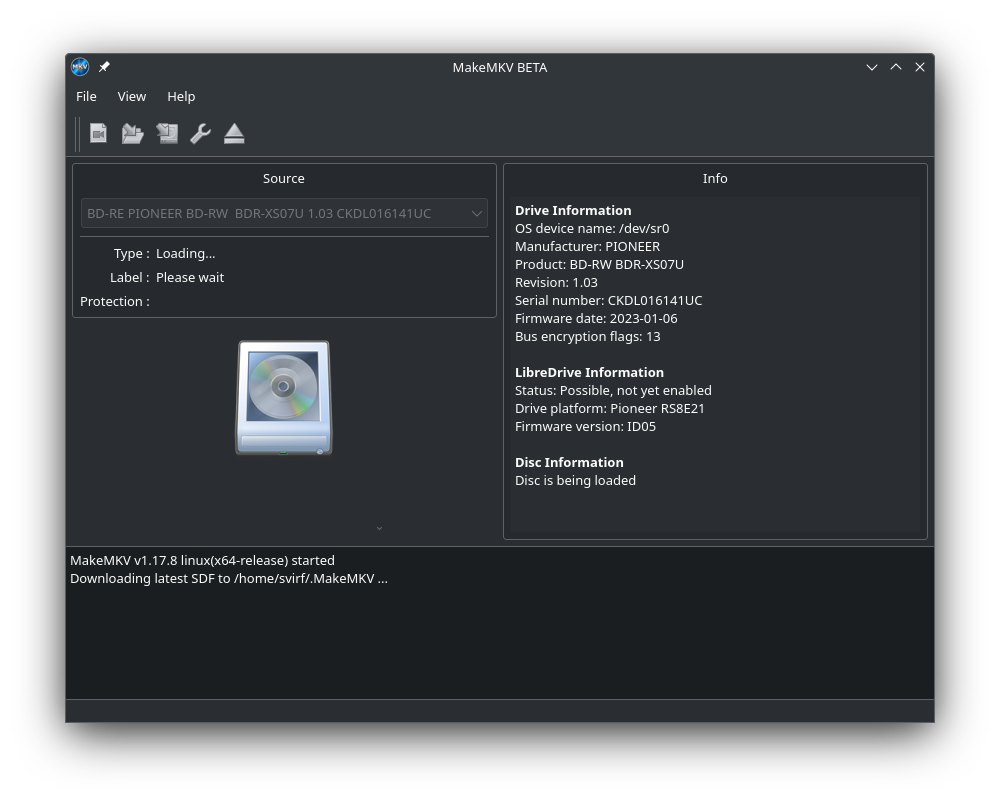

Hey there everyone...
I have been trying to get MakeMKV to work since 1.17.8 was released. All I get is this:
With a disc in the drive, it does nothing but spin, and spin, and spin... Eventually I can hear the drive stop spinning, but MakeMKV does nothing different.
I am using Manjaro Linux, and I have tried the AUR version, the Flatpak Version, the AppImage Version, and the Snap Version. they all do the same thing.
I have cleared out the /home/svirf/.MakeMKV folder every time I change the version.
I have followed the information in viewtopic.php?f=3&t=16939&start=45 to even get the drive to register.
I am truly at my wits-end here. I cannot get this to function at all. Can someone PLEASE help?

Post by LuminousEssence »
I am on arch linux and I have the same issue. I wasn't able to resolve it even after an hour of investigation. In the end, I plugged the external drive into my mac mini and used the MacOS software, here it works without issue.
As I plan to buy the software, I would ask for this issue to please be fixed. I would feel bad spending money on something that doesn't work on my main PC. Thanks.
epeoples

100% agree. This program just doesn't work. It just doesn't. I paid for the full version and can't use it. After hours and days of f'ing around with it, I don't even want it anymore.

Has this issue been fixed yet ? I am still experiencing the same issues. I have made sure I am part of the CD rom groups ect..
VLC can see my drive and play dvd's just fine and so does k3b and dvdbackup apps.
The problem is Makemkv complains about not able to get full access to drive and just wont load the disc when entered.
I have tried Ubuntu , Arch , Debian , MInt and it just wont run Makemkv properly. I boot into WIndows and whammo it magically works.
Any one get it working in linux lately and what is the work around?

I have been struggling with the same issue for awhile. I finally came across anther post that discovered version 1.17.7 will not cause an optical reader to hang when reading a disc on linux.
I have tested this on Mint/Debian and can confirm it works.

I had the same problem with version 1.18.3 and a downgrade to 1.17.1 fixed it.
But today I flashed the firmware of my BD drive like described in "Ultimate UHD Drives Flashing Guide Updated 2026" and now it also works with the newest version.
