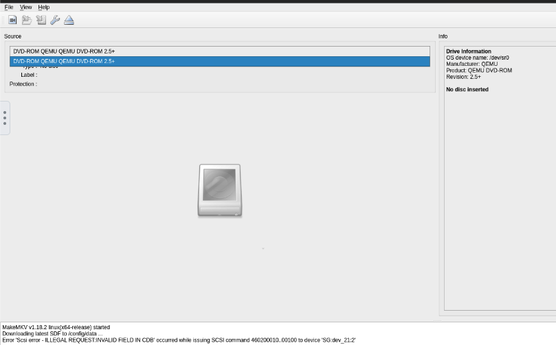

Hi and thanks for your reply!
I tried it and it still does not work.
Maybe proxmox pass through mechanic is the problem.
I will try putting it back into the USB Enclosure and connect it there and pass through the USB Port …
Or does the screenshot indicate anything else i could try?
Bildschirmfoto 2025-11-20 um 07.23.47.png (46.17 KiB) Viewed 11750 times

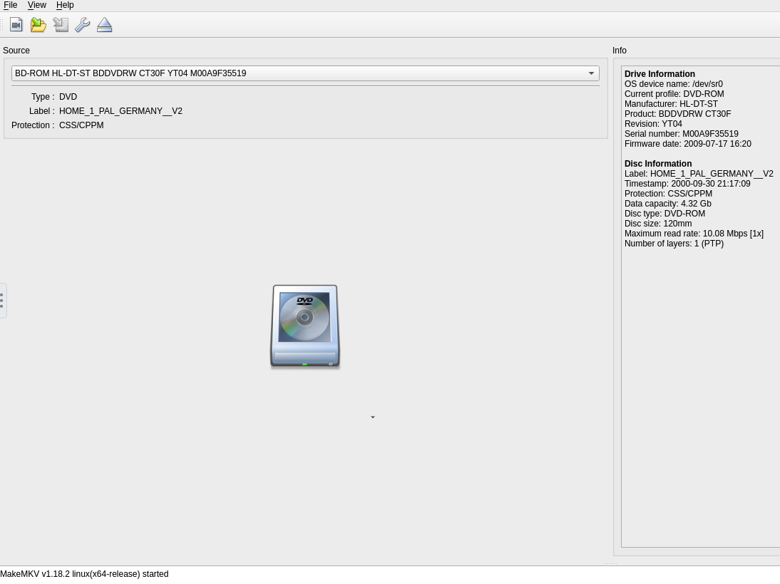

Hello
pass through via Proxmox did not work (via the UI).
It was a generic "pass through standard dvd drive".
I had to pass the controller directly in the host OS.
1. Unbind the proxmox connection
2. bind raw PCIe device with ID
Sorry i have no further instructions - i used chatgpt for help but it works now.
An easier option would be to directly install it on the host os not inside proxmox / docker but i wanted to go this way.
Bildschirmfoto 2025-11-20 um 09.51.12.png (112.28 KiB) Viewed 11747 times
