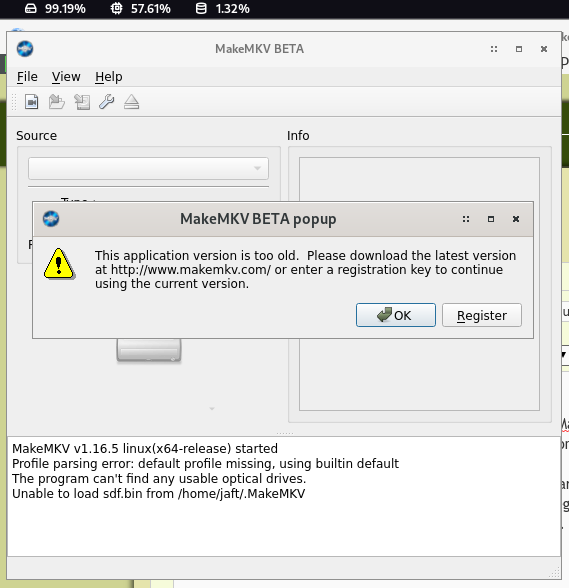

The makemkvcon executable seems to work perfectly, as far as I can tell; but the application doesn't seem to be able to recognize whether the beta is still within the key or, if a registration key is even used, it seems to not store the key in any way that it can remember and check against, in the future.
Screenshot from 2022-01-14 23-03-31.png (42.77 KiB) Viewed 11425 times
Launching the app. immediately states that it's not the latest version (which, as viewable in the screenshot, shouldn't be true as it identifies itself as version 1.16.5.

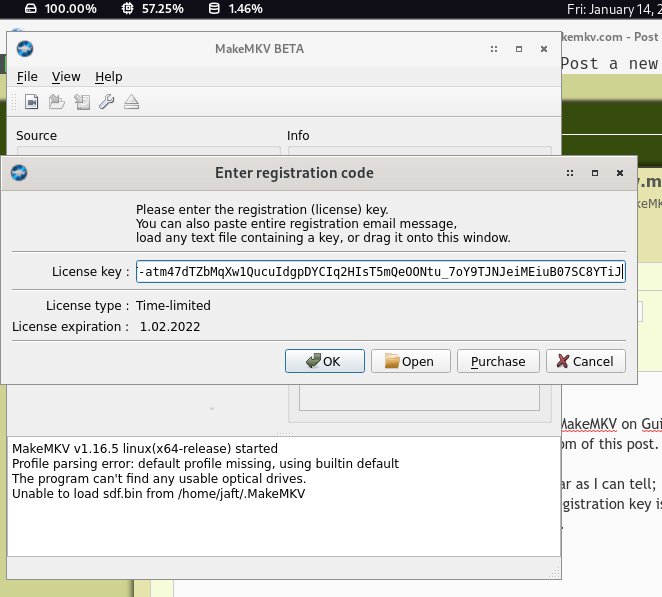

But, in any case, I figure, "O. K.; well, – if I put in the key for the beta, manually – I should get around the weird behavior as any version can be used with a registration key."
Screenshot from 2022-01-14 23-04-08.png (63.09 KiB) Viewed 11425 times
The app. seems to recognize the key and the expiry date as the first of February so I think this should suffice and hit O. K. but that just causes the app. to close; running the makemkv command from the command line and doing this again doesn't display any kind of error in the terminal so I'm not sure if this is crashing or otherwise. Reopening the app. just results in the same behavior as before in every way except that clicking Register automatically loads the key, again, so I don't have to type/paste it in, again.
Anyway, the short of this post is that if I could get some insight into how MakeMKV verifies (and marks as valid, for future use) the key, that'd be great as I'd, then, be able to get this working for others on Guix to easily use.

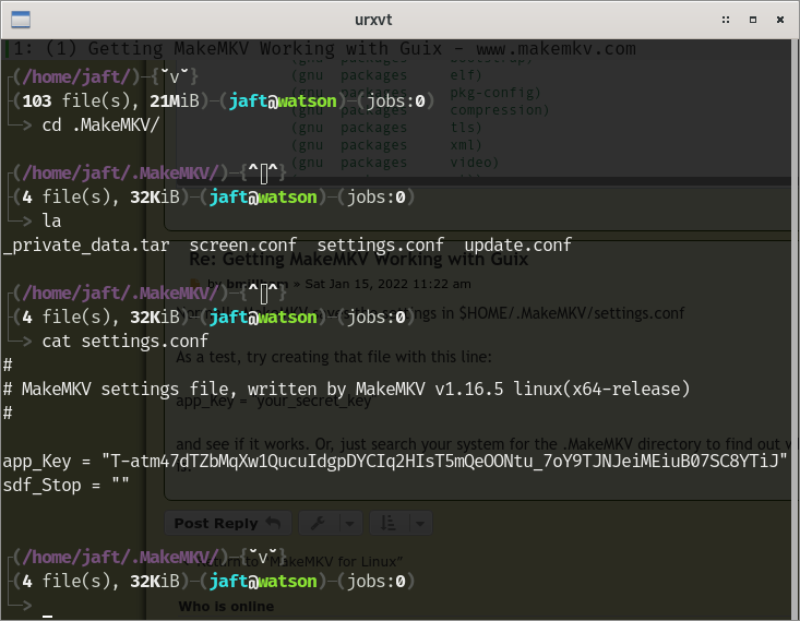

Normally MakeMKV saves the settings in $HOME/.MakeMKV/settings.conf
As a test, try creating that file with this line:
app_Key = "your_secret_key"
and see if it works. Or, just search your system for the .MakeMKV directory to find out where Guix thinks the users home is.
blah1989z
Joined: Wed Jan 05, 2022 1:13 am
Re: Getting MakeMKV Working with Guix
Post by blah1989z » Sun Jan 16, 2022 1:43 am
Looks like MakeMKV generated both the directory and settings.conf file:
Screenshot from 2022-01-15 19-40-45.png (133.13 KiB) Viewed 11401 times
I'm guessing this is why it knows how to load that particular key every time I go back to Register? So no dice there, unfortunately.
