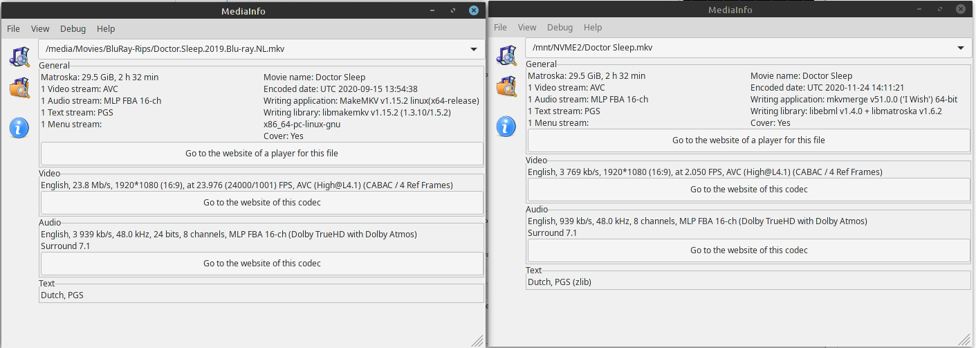

The main issue is that the file written by makemkv does not work while the version i created with mkvtoolnix of the same file does work.
That get me thinking about possibly older libs in makemkv?
In this screenshot of mediainfo, on the right side is my new created file, left the version written by makemkv

One thing I notice is the data rate for both the audio and the video is different between the two. It looks like the one on the right, created by mkvtoolnix, has transcoded the file.
I don't know what version of MediaInfo you're using, but the the 20.09 version (https://mediaarea.net/MediaInfo/ChangeLog) has updates to understand the new way Dolby Vision is stored in mkv files.
Also, it seems you a're running MakeMKV version 1.15.2. 1.15.3 is the newest version, so it might be worth giving that a try.

As far as i know mkvtoolnix is a muxer not a transcoder? But sure i noticed that too, but it looks strange agree
