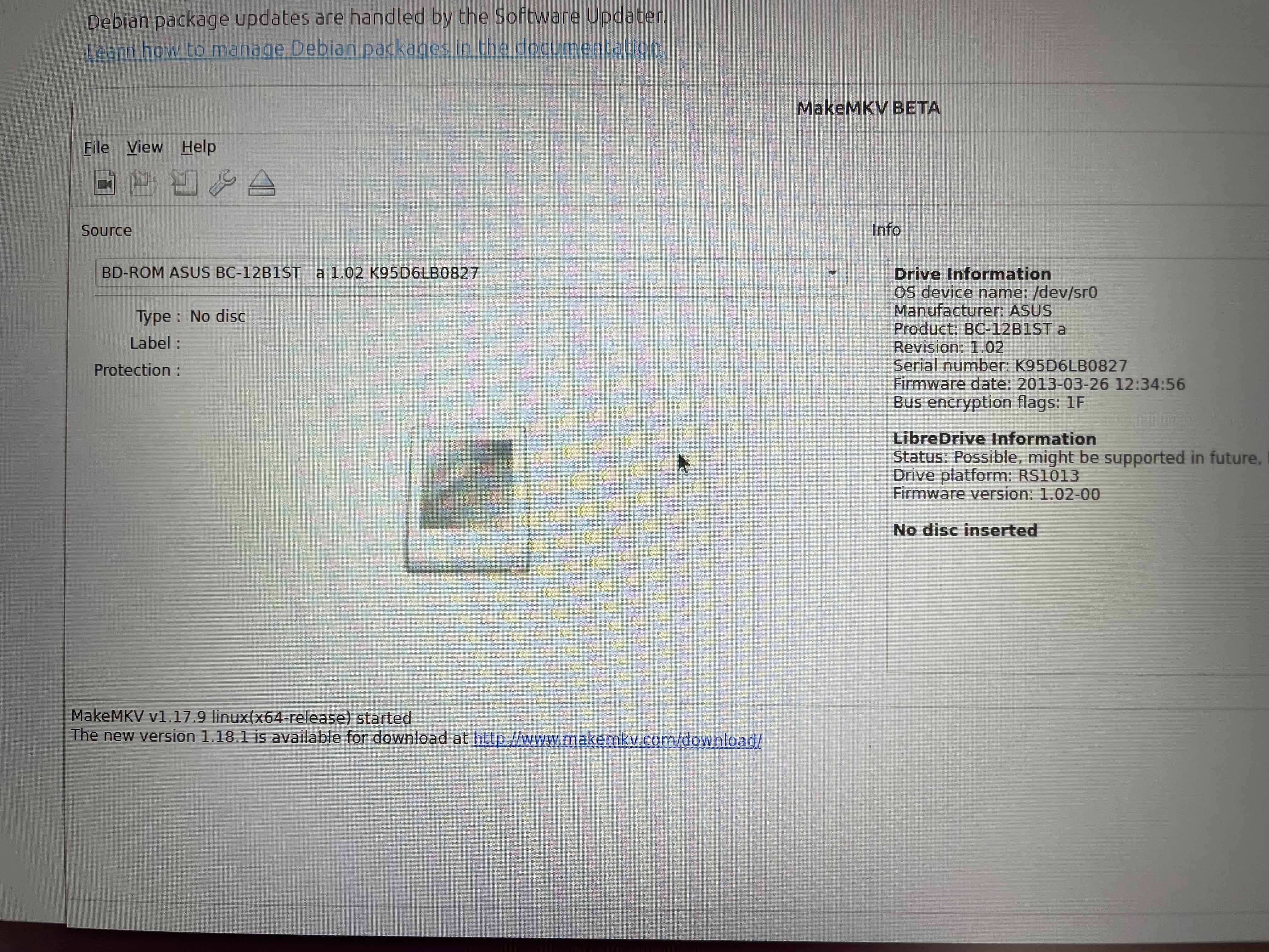

#3 Post by lifeinajug » Wed Apr 09, 2025 8:15 pm
Here's the MakeMKV drive info...

I can mount it in Ubuntu and explore files on the disk, but if I start MakeMKV with a disk in the Bluray drive it will keep trying to read the disc and MakeMKV will be stuck.
For this part, it's possible that gnome's automounter is trying to access the bluray drive at the same time, which could cause MakeMKV to time out and not detect the disc.
You can try disabling gnome's automounter with these commands. Keep in mind that changing this setting will also affect other drives like USB storage.
gsettings set org.gnome.desktop.media-handling automount false
gsettings set org.gnome.desktop.media-handling automount-open false
