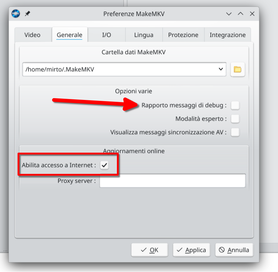

The log will tell whether or not MakeMKV can reach the internet. If your logging settings are set high enough, that is. The default is rather low, in my opinion, but it is easily switched.
In program settings, General, "Enable Internet access" checked sets that up. It's been checked so long on my copies that I can't remember if it is automatic or not. :)

#5 Post by mirto » Tue Mar 28, 2023 5:36 pm
Well, it seems that internet access is already enabled.
Have i to select the debug log option and try again to give more information?
Posts: 10926
Re: Seems makemkv don't see the KEYDB.cfg file
#6 Post by Woodstock » Tue Mar 28, 2023 6:26 pm
Yes, add a check mark for debug information being recorded. Your log window will show more stuff, and the log FILE for the application will grow even more.
You should be able to tell from the log file if it is able to download the disc decryption data, or if it had an error doing so.

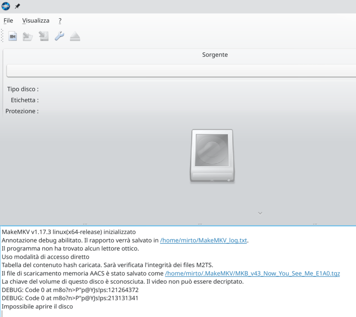

#7 Post by mirto » Tue Mar 28, 2023 7:06 pm
Here are the log window and the generated file.
But I don't see anything I can understand.
What can I try?

The window log was
MakeMKV v1.17.3 linux(x64-release) started
Debug logging enabled, log will be saved as /home/mirto/MakeMKV_log.txt
The program can't find any usable optical drives.
DEBUG: Code 16842752 at '5BE>tA"Gf|~89y(o3:121264027
Using direct disc access mode
Saved AACS dump file as /home/mirto/.MakeMKV/MKB_v43_Now_You_See_Me_E1A0.tgz
DEBUG: Code 0 at m8o?n>P"p@YJs!ps:121264372
DEBUG: Code 0 at m8o?n>P"p@YJs!ps:213131341
Failed to open disc
