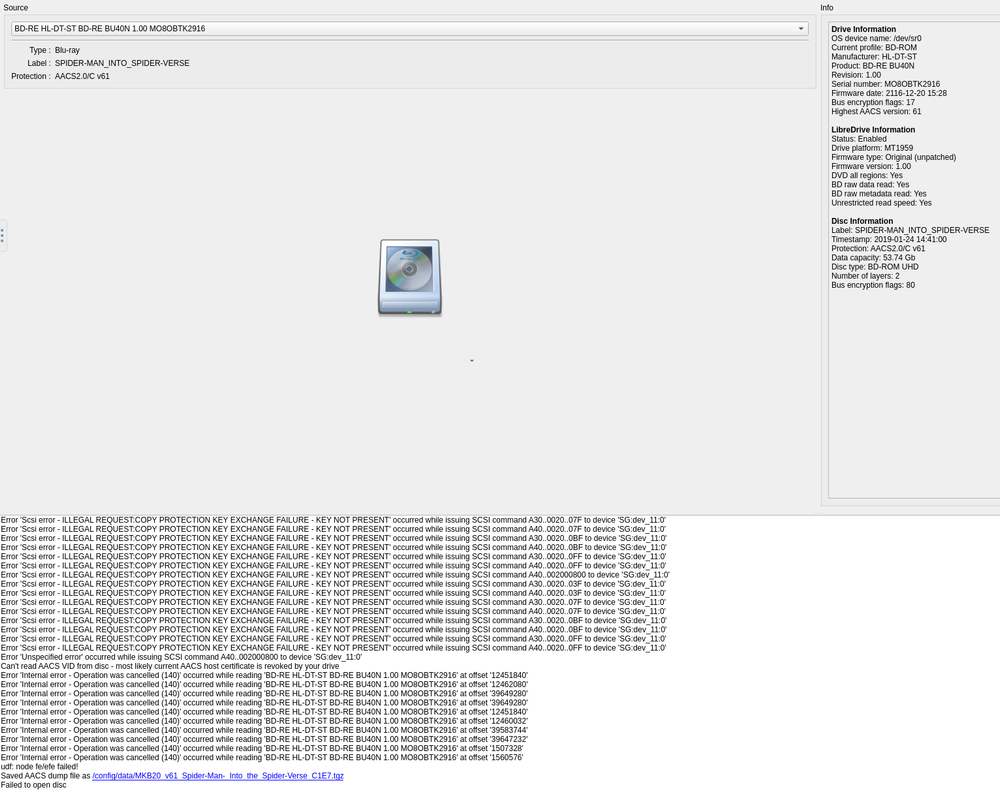

I'm having the same issues as described in this thread after testing 4k RIPS on my windows machine and then installing into my TrueNas box.

Error 'Scsi error - ILLEGAL REQUEST:COPY PROTECTION KEY EXCHANGE FAILURE - KEY NOT PRESENT' occurred while issuing SCSI command A30..0020..07F to device 'SG:dev_11:0'
Attempted to fix by downgrading to the 1.0 Firmware. No luck. Think I am going to just throw in the towel on having the 4k Ripper in the NAS Box and buy an enclosure for it on the desktop. I seem to still be able to pull blu-rays ok on TrueNAS. Just would of been nice for workflow to be able to dump everything onto the NAS and work back from there.

If anyone comes along to this issue, I solved it by having only the container device exposed to makemkv and not the device name.
In my case it was
Device name: /dev/sr0
Device Container: /dev/sg4
I made an educated guess on this from the makemkv container github calling out that "Not exposing the Device name may cause performance issues". In my case I was already exposing it and the TrueNAS app forces you to input both. I converted it to a custom app to get just the YAML.
In the section for device change
- /dev/sr0:/dev/sg4
to
- /dev/sg4
No I do not know why this worked. When checking in the shell with lsscsi -g the drive shows as /dev/sr0 /dev/sg4.
Tried this after a second drive had this same issue. Can now open and rip UHD after making this change.
