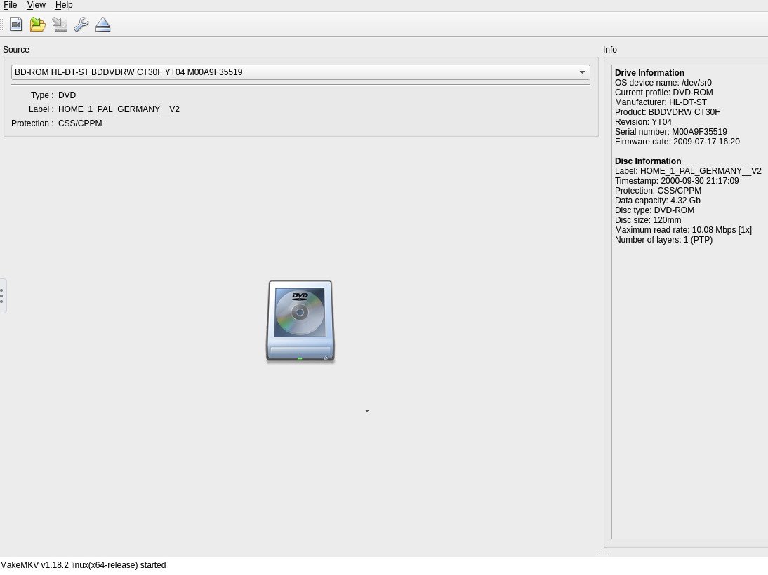

Or does the screenshot indicate anything else i could try?
Bildschirmfoto 2025-11-20 um 07.23.47.png (46.17 KiB) Viewed 245 times
Bildschirmfoto 2025-11-20 um 09.51.12.png (112.28 KiB) Viewed 242 times
