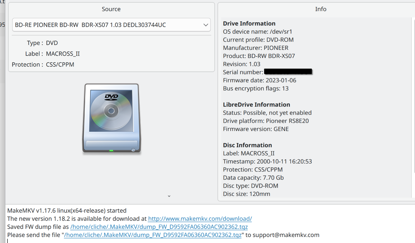

actually things only went fine with some of my drives. I read anther thread about the app not working correctly on linux and users mentioned something abut firmware dumping and an old version of the software.
So, you can still get old versions at https://makemkv.com/download/old/ and specifically https://makemkv.com/download/old/makemk ... 7.6.tar.gz worked for me. I just went into the folder for the old version did make && make install. Then the one drive that was problematic gave me a screen that mentioned dumping firmware. when I went back to 1.18.2 it still seems to work fine.
