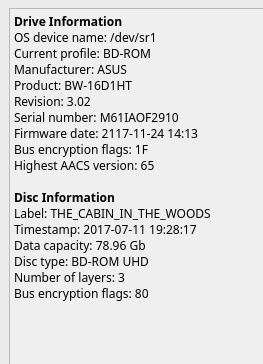

So I downloaded the 3.02 firmware for my ASUS BW-16D1HT and flashed that, and afterward was able to do a test rip on the windows machine I was using without any issue. Afterwards I installed it in my Linux machine (Mint 19.1) and when I go to try and rip a disk I get:
MakeMKV v1.14.3 linux(x64-release) started
Automatic checking for updates is enabled, you may disable it in preferences if you don't want MakeMKV to contact web server.
Using direct disc access mode
Saved AACS dump file as /home/<user>/.MakeMKV/MKB20_v61_THE_CABIN_IN_THE_WOODS_2565.tgz
Failed to open disc
I have already tried uninstalling and reinstalling MakeMKV but that did not seem to help. Any advice would be appreciated!
