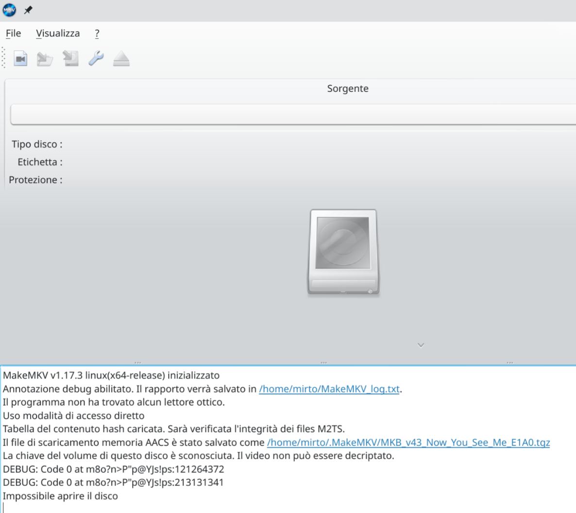

Here are the log window and the generated file.
But I don't see anything I can understand.
What can I try?

The window log was
MakeMKV v1.17.3 linux(x64-release) started
Debug logging enabled, log will be saved as /home/mirto/MakeMKV_log.txt
The program can't find any usable optical drives.
DEBUG: Code 16842752 at '5BE>tA"Gf|~89y(o3:121264027
Using direct disc access mode
Saved AACS dump file as /home/mirto/.MakeMKV/MKB_v43_Now_You_See_Me_E1A0.tgz
DEBUG: Code 0 at m8o?n>P"p@YJs!ps:121264372
DEBUG: Code 0 at m8o?n>P"p@YJs!ps:213131341
Failed to open disc
