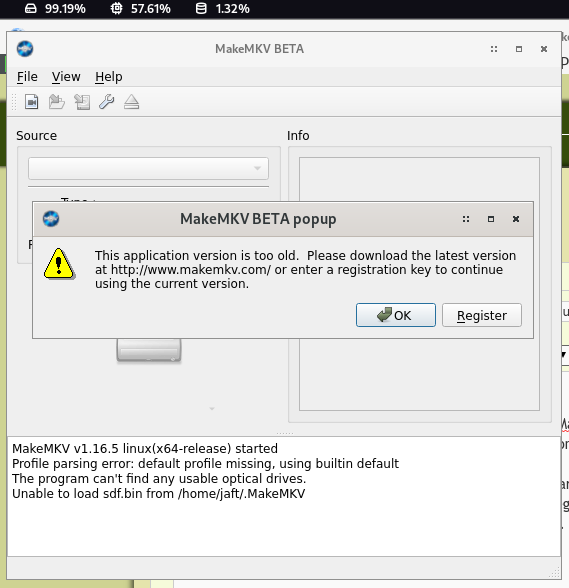

Launching the app. immediately states that it's not the latest version (which, as viewable in the screenshot, shouldn't be true as it identifies itself as version 1.16.5.

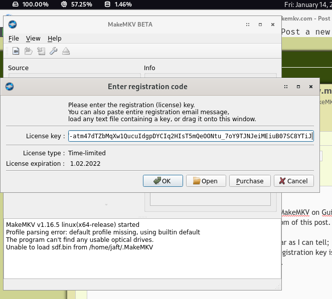

But, in any case, I figure, "O. K.; well, – if I put in the key for the beta, manually – I should get around the weird behavior as any version can be used with a registration key."
Screenshot from 2022-01-14 23-04-08.png (63.09 KiB) Viewed 12071 times
The app. seems to recognize the key and the expiry date as the first of February so I think this should suffice and hit O. K. but that just causes the app. to close; running the makemkv command from the command line and doing this again doesn't display any kind of error in the terminal so I'm not sure if this is crashing or otherwise. Reopening the app. just results in the same behavior as before in every way except that clicking Register automatically loads the key, again, so I don't have to type/paste it in, again.

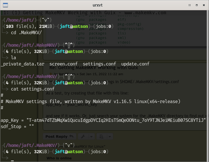

Normally MakeMKV saves the settings in $HOME/.MakeMKV/settings.conf
As a test, try creating that file with this line:
app_Key = "your_secret_key"
and see if it works. Or, just search your system for the .MakeMKV directory to find out where Guix thinks the users home is.

Looks like MakeMKV generated both the directory and settings.conf file:
Screenshot from 2022-01-15 19-40-45.png (133.13 KiB) Viewed 12047 times
I'm guessing this is why it knows how to load that particular key every time I go back to Register? So no dice there, unfortunately.
