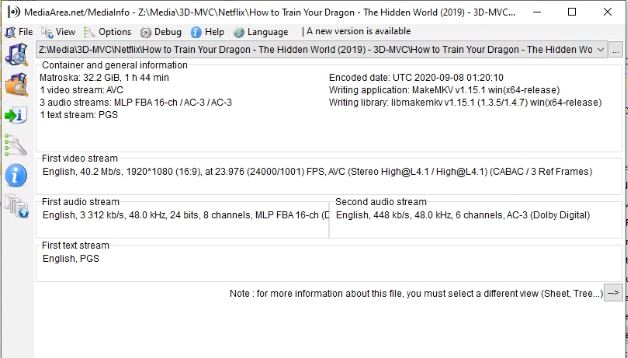

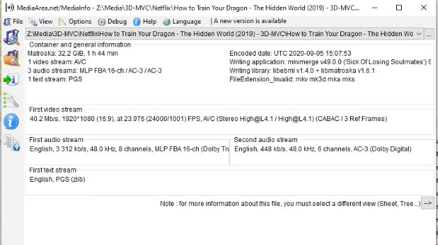

How do you know if the rip was encoded properly? I use MediaInfo to analyze files, but I ripped one using v1.15.2.:Krobar wrote: Fri Sep 04, 2020 12:53 pm Same for me with Kodi. The MVC codec does not get used with rips from 1.15.2, they just use the standard H264 codec and show in 2D.
This info was taken on the exact same file after I reinstalled v1.15.1 and ran that same file through and re-saved it as per this post:
viewtopic.php?f=8&t=22720#p94647

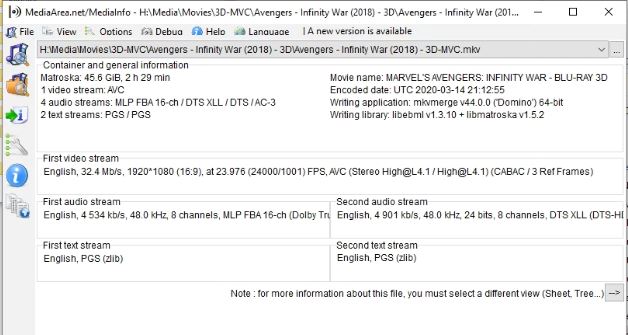

Is there something in here that I should be able to see as "proof" the file is correct now? if I look at a rip that I made last year for example:
- Capture2.JPG (49.58 KiB) Viewed 47477 times

I noticed that when installed v1.15.1 then opened the files I made in v1.15.2, I had to re-select the MVC track. It was not chosen by default. That is something I would have to do from a BR source, but wanted to add that here because if someone "just open this file with 1.15.1 and save to another MKV" but did NOT re-select that track, I'm guessing it would not be in the new file either.
