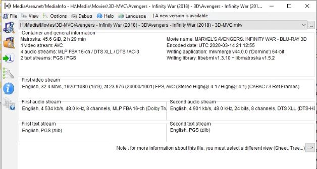

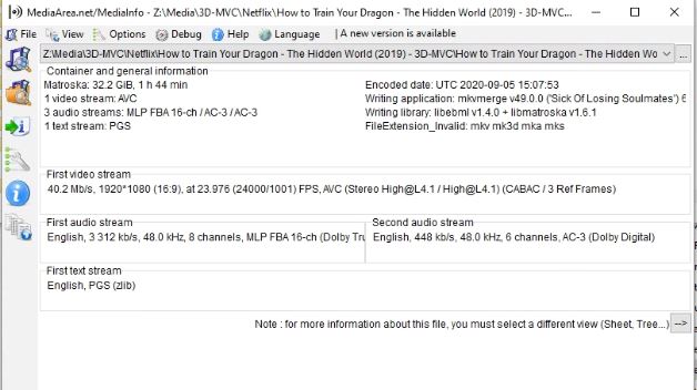

How do you know if the rip was encoded properly? I use MediaInfo to analyze files, but I ripped one using v1.15.2.:

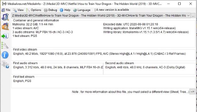

This info was taken on the exact same file after I reinstalled v1.15.1 and ran that same file through and re-saved it as per this post:
viewtopic.php?f=8&t=22720#p94647
Is there something in here that I should be able to see as "proof" the file is correct now? if I look at a rip that I made last year for example:
- Capture2.JPG (49.58 KiB) Viewed 46554 times
