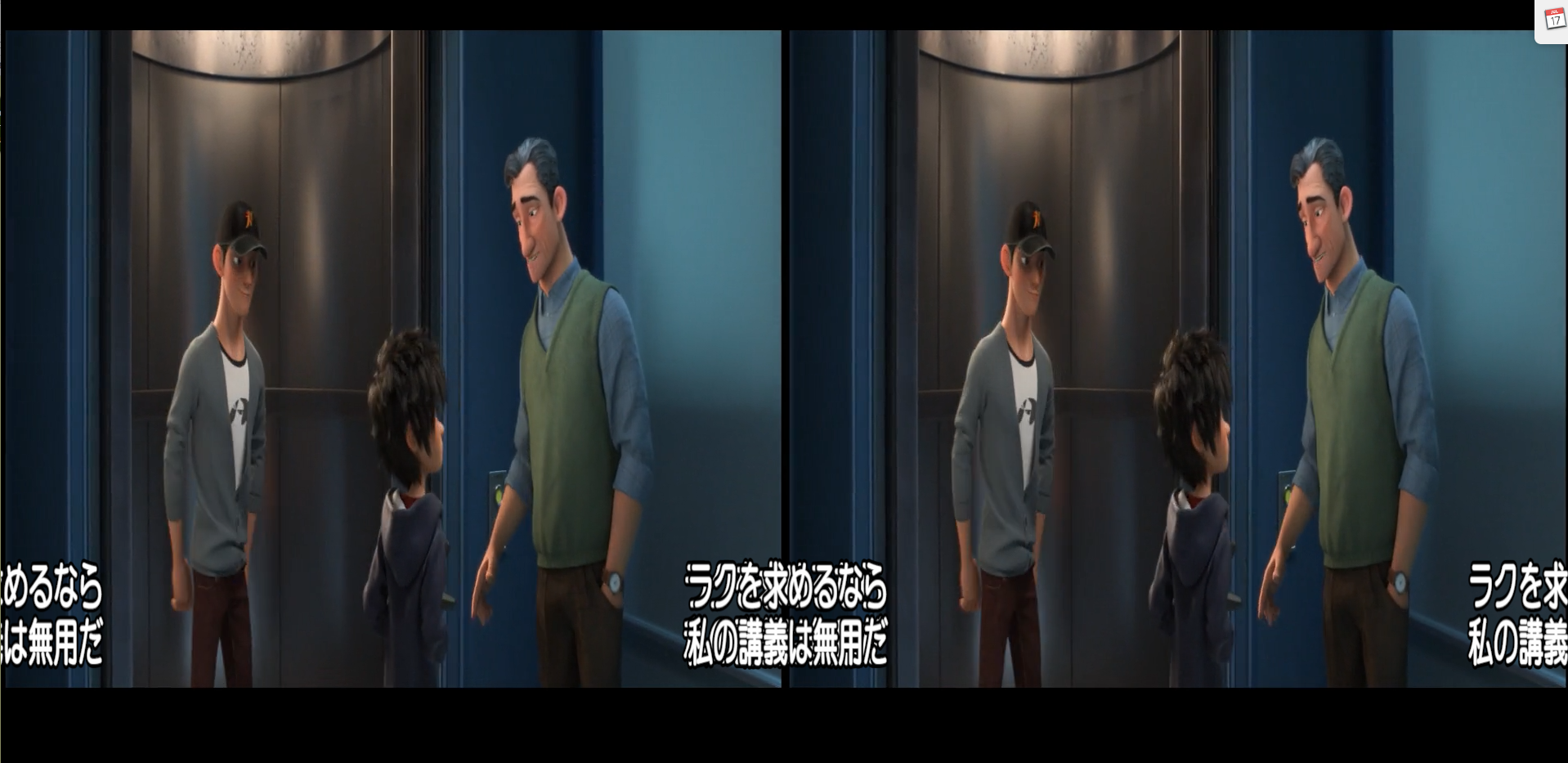

I'm having a problem with 3D subtitles. When viewing the SBS image, the subtitles appear spit on each extreme side and also appear as 3D offset text in the middle of the image. See the attached screenshot. When viewed in 3D, on my 3D LG via Plex, the resulting subtitles are a mess.
screenshot from PotPlayer X
Screen Shot 2022-05-30 at 12.57.45 PM.png (1.35 MiB) Viewed 104557 times

Looks like either you ripped the subtitles wrong, or your player isn't using the right settings. Have you been able to play SBS movies (maybe downloaded ones) before, or is this your first time watching 3D with subtitles on this setup?
Usually, for a SBS rip, the subtitles should be like that as well, with the PGS file having the same line 2 times next to each other. You can verify if this is done correctly by opening the movie in a non-3D player or looking at the PGS in BDSup2Sub or something.
You should see the same sentance twice next to each other, one for the left image, and one for the right image, just like the video is.
If you only see the same sentance one time, you ripped the subtitles wrong. Go back and rip them properly.
If the subtitles are ripped correctly, your player is not "SBS-ing" your subtitles, probably meaning it's doing the subtitle rendering AFTER it's overlaying the 2 SBS images, while it should do so BEFORE. PotPlayer actually has a setting where you can control this. Setting this will fix your problem in PotPlayer.
Now getting it to work properly on hardware can be a bit trickier. I have no idea how either Plex or an LG TV handles 3D content/subtitles (let alone in combination), so you're on your own there. You need to try to make sure the rendering of the subtitles happens before the 2 SBS images are overlayed to create one 3D image. When are the 2 SBS images overlayed? If Plex does this, you need to try to get Plex to "SBS" the subs. If Plex outputs 2 images and your TV overlays the 2 images you need Plex to output the subtitles untouched, with the 2 sentances next to each other.
So, depending on your setup, the way to get it to work will differ. If your TV has a SBS mode, it's probably best to use that and have Plex output everything as plain 2D, with the video and subtitles both appearing two times next to each other (when your TV is not in SBS mode, obviously).
Hope this helps.
