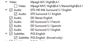

And this is what I am seeing:
What I'm seeing.jpg (40.59 KiB) Viewed 39333 times
Notice the difference of "Mpeg4-MVC-3D" vs "Mpeg4 MVC High@L4.1/StereoHigh@L4.1"

You need to select the nested MVC track, which is the 3D second eye track. The wording has changed a bit, but “MVC” is the key term. No downgrade needed.

Assuming you’ve selected both the AVC and MVC tracks for ripping, there should be no issues from MakeMKV’s side. MakeMKV is simply copying the video streams off the disc into the MKV container, so as far as I know, there shouldn’t be any firmware issue if MakeMKV is doing its job.

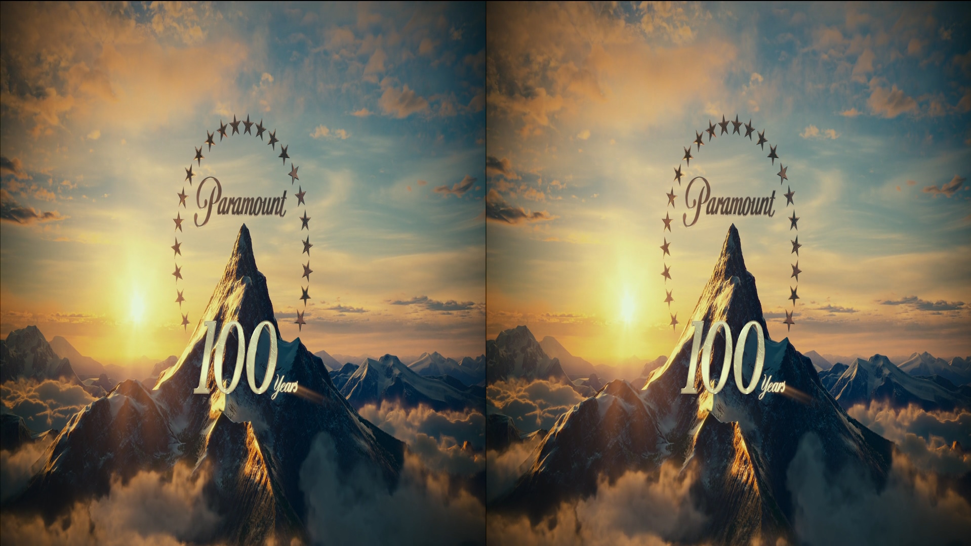

I'm working in the 3D release of Titanic. I've provided screenshots to help narrow down my issue.

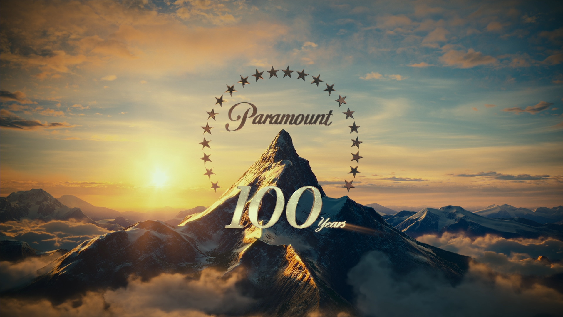

Screenshot from the processed MKV, not touched with BD3D2MK3D:
Screenshot of 3DMKV, processed through BD3D2MK3D:

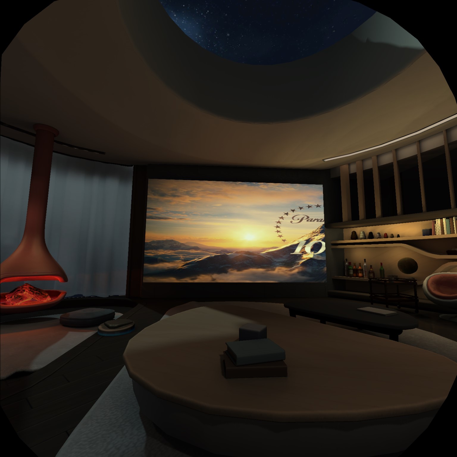

Screenshot of file playing in BigScreenVR (my video player):
I'm not too sure of the source of the issue, but assuming that it only appears to be an issue in the player, that may be it.

Update: My hunch from earlier was correct, it was the player. I opened the movie in Skybox and it works perfectly. :D
Apparently BigScreen does not work with Full SBS files.
Thank you for sticking with me through this little adventure!
MrMason
Joined: Sat Jun 05, 2021 9:58 pm
Re: Completely Confused
Post by MrMason »
I had the same problem converting mkvs from 3D blurays in full-SBS or full-OU format using BD3D2MK3D and Bigscreen, plays with Skybox just fine. To make it work with bigscreen delete the --frame-packing 4 option from __ENCODE_3D.cmd and the "--stereo-mode", "0:3" option from __MUX_3D_OPTIONS.json before running the __ENCODE_3D_LAUNCHER.cmd
