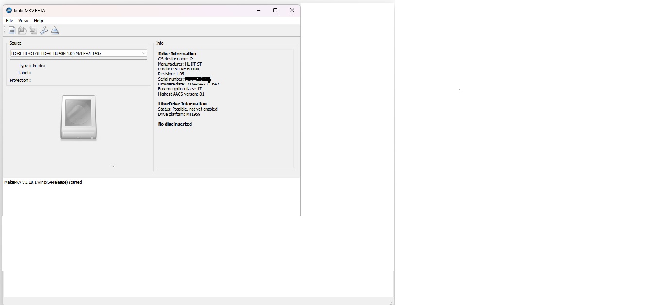

Hello - Please let me know if this drive would be able to flash for UHD - Thanks
OS device name: G:
Product: BD-RE BU40N
Revision: 1.05
Serial number: NA
Highest AACS version: 81
Verbatim 43888 - Need help to enable UHD

Re: Verbatim 43888 - Need help to enable UHD
see guide below or email me or marty for an auto flasherPackers948 wrote: ↑Sun Jul 27, 2025 5:45 pmHello - Please let me know if this drive would be able to flash for UHD - Thanks
OS device name: G:
Revision: 1.05
Serial number: NA
@Billycar11 - If I read the instruction correctly then this would be a correct FW to flash this drive - "BU40N on any Firmware directly to > BU40N 1.03MK".Billycar11 wrote: ↑Sun Jul 27, 2025 6:51 pmsee guide below or email me or marty for an auto flasherPackers948 wrote: ↑Sun Jul 27, 2025 5:45 pmHello - Please let me know if this drive would be able to flash for UHD - Thanks
OS device name: G:
Revision: 1.05
Serial number: NA
- Posts: 5742
With encPackers948 wrote: ↑Tue Jul 29, 2025 12:57 am
@Billycar11 - Thank you for the reply - This would be the file to flash the drive right - HL-DT-ST-BD-RE_BU40N-1.03-NM00000-211810241934.bin (from The all you need firmware pack0 - ThanksBillycar11 wrote: ↑Tue Jul 29, 2025 2:01 amWith encPackers948 wrote: ↑Tue Jul 29, 2025 12:57 am
- Posts: 5742
YeahPackers948 wrote: ↑Wed Jul 30, 2025 8:49 pm@Billycar11 - Thank you for the reply - This would be the file to flash the drive right - HL-DT-ST-BD-RE_BU40N-1.03-NM00000-211810241934.bin (from The all you need firmware pack0 - Thanks
