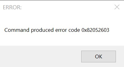

Re: LG WH14NS40 sdf tool throwing error while flashing
I tried doing this today and I got a error message with both versions
Need help please
Need help please
- Screenshot 2024-12-20 111317.jpg (10.28 KiB) Viewed 4755 times
- Posts: 4868
More info required....
What drive? What firmware is on the drive? What firmware are you trying to flash? Provide the drive/libredrive info from MakeMKV.
